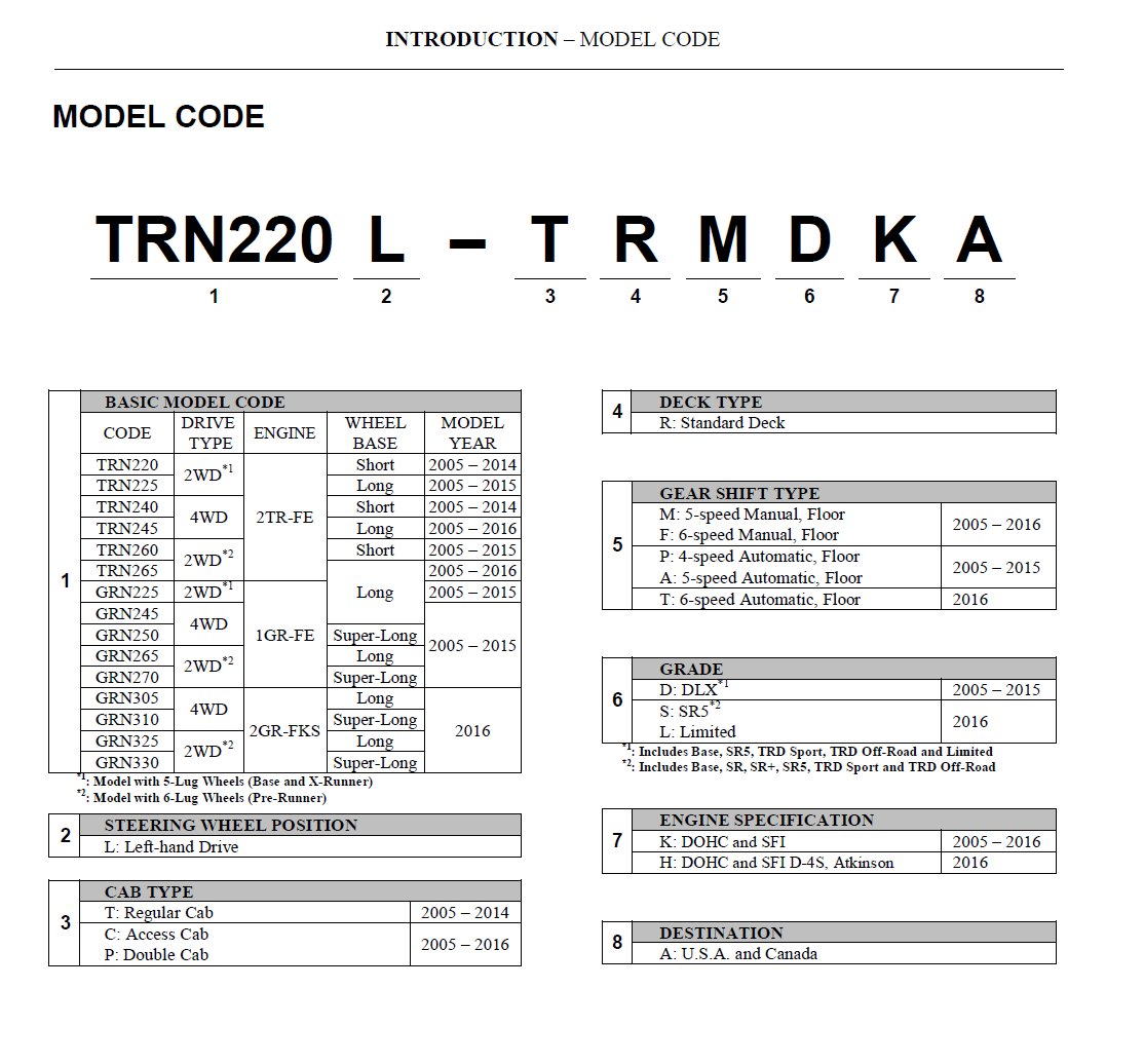

    You need to find a katashiki decoder:
    List of Chassis Codes. Do you know yours? VZN??? RVN??? | Tacoma World
  9. Aug 8, 2023 at 2:08 PM
    #29
    mcartler
    mcartler [OP] Member
    Aug 8, 2023
    #430797
    13
    I found a VIN decoder to model number so maybe I will make a Gen 3 version. Might be handy as there is variability - for example a 4WD double cab can either have 6000lbs or 6400lbs towing capacity depending on the model

    The reason for my original question is that based on the owners manual, V64x4s can have 6000, 6400 or 6500lbs towing rating depending on the model. It isn't clear to me if the transmission is a variable in those differences
  12. Aug 8, 2023 at 5:47 PM
    #32
    BLtheP
    BLtheP Constantly Tinkering Member
    Apr 5, 2022
    #394355
    4,321
    Plano, TX
    2021 MGM TRD On-Road DCSB MT
    RC60F Transmission 5.29 R&P FJ Metal Clutch Pedal OEM Mexico-Spec Condenser Fan 265/70R16 Michelin Defender LTX M/S 2 OEM 1-Piece Lug Nuts Custom Built Switch Panel for all Electrical Accessories Rigid Amber Pro D-SS Ditch Lights Rigid 30" SAE High Beam Driving Light Bar Rigid SR-Q Pro Back-Up Light Kit (Recessed) VLEDS Tail Conversion VLEDS Bed Light Kit VLEDS Foot Well Light Kit KC HiLites Cyclone V2 Under Hood Lights Customized 2WD Low Operable (Switched) Clutch Safety Bypass
    Transmission is not a factor for towing. It is a factor for payload.
    All of these are V6 4x4:
    6500 lbs
    GRN305L-CRFSHA - access cab manual
    GRN305L-CRTSHA - access cab auto
    6400 lbs
    GRN305L-PRFSHA - double cab manual
    GRN305L-PRTSHA - double cab auto non Limited
    GRN305L-PRTLHA - double cab auto Limited
    GRN310L-PRTSHA - double cab long bed (auto only) non Limited
    6000 lbs
    GRN310L-PRTLHA - double cab long bed (auto only) Limited
    the only one that doesn’t make sense to me is the limited long bed losing 400 lbs compared to the “SR5” DCLB. The short bed limited doesn’t lose 400 lbs compared to the short bed “SR5”.

    @BLtheP - I missed your earlier post - THANK YOU! That is exactly what I was looking for - will really aid in my search. I like the look of the double cab alot better than access cab, but the access cabs slightly better towing capacity might win out. I will very rarely need to take passengers in the truck so the smaller rear seat would not be a problem.
