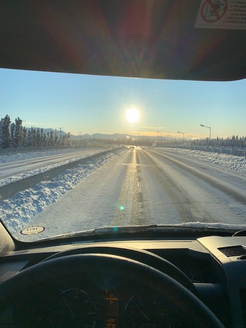

    IPT
    IPT Well-Known Member
    Sep 15, 2020
    #340911
    85
    Lou
    Ours sure does. Here is a typical road in my region for about 4+ months a year. Thats packed down snow and it's there for the season most times. They basically use graders here to "plow" the roads. You can imagine what if gets like at the intersections where exhuast is melting the snow/ice only yo have it freeze right back up.
    People get around here just with RWD, and or front wheel drive, some with crap tires. For me the money is well worth it. I've seen people stuck on a few degrees of grade at a light before. Personally for the money it's worth the money to (mostly) be able to start and stop my Van when I actually want to. Heck, sometimes I need 4wd and winter tires just to get out of my driveway :) (it's steep). Your conditions may vary!
