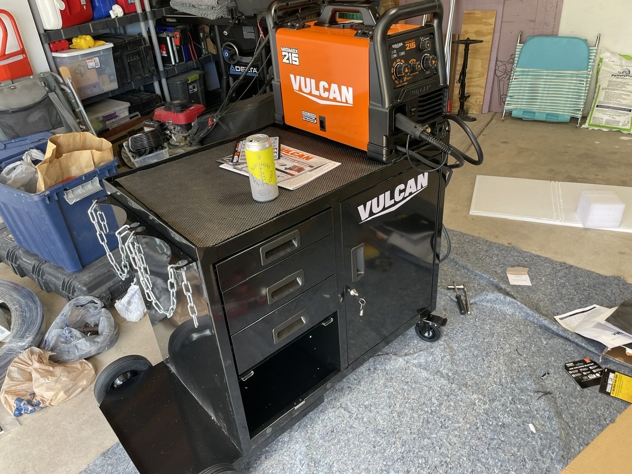

    Time to start the real mods soon!
    It’s not the fanciest. But I just couldn’t justify several thousand dollars for something I’ve never done. So I got myself a cheap but recommended by a few people VULCAN migmax 215 mig welder and a few accoutrements. And a welding cart.
    Next I need to get a helmet, a bottle of gas and get 220 hooked up in the garage (shouldn’t be a problem since we have 220 in the next room for the dryer)
    Ignore the mess I have 3 other projects going this weekend.

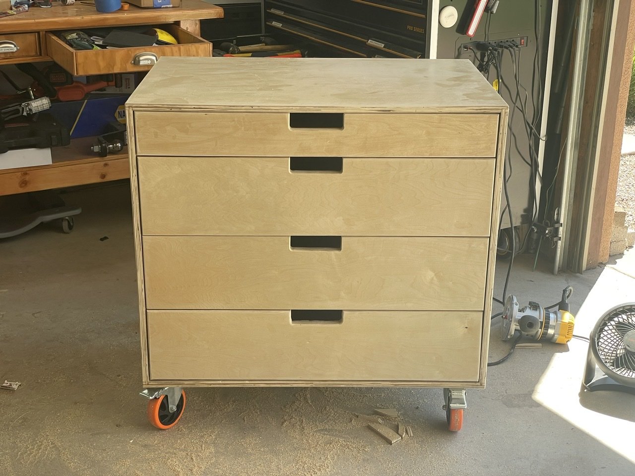

    To continue with the garage organization, I finally finished building my cabinet. It’s not perfect but not bad for my first real woodworking project. Plus it’s for the garage so it will get beat up anyways.

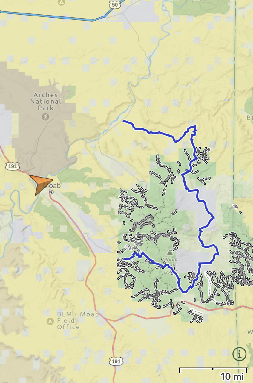

    Another Utah trip on the books this weekend.
    Wife and I had a backroads camping adventure planned for this weekend but she is in a boot for a foot injury. So no climbing RTT ladders for her.
    At the last minute we decided on Moab. In part because we got a great deal on a hotel room. And oddly Moab was super quiet this weekend.
    I wanted to explore some mild trails we hadn’t done up there since she can’t get out and spot.
    So Saturday we did about 75 miles of dirt. Left Moab up and over La Sal Pass, random dirt roads behind the La Sals and back to Moab via Onion Creek. Onion Creek was interesting, the rest was pretty bland.
    Today we went up Long Canyon, side trip to Day Canyon Point (rated 5, low end of hard, one big set of steps give it that I think. The rest was moderate), then down Shafer Trail, which we’ve done but is always beautiful.

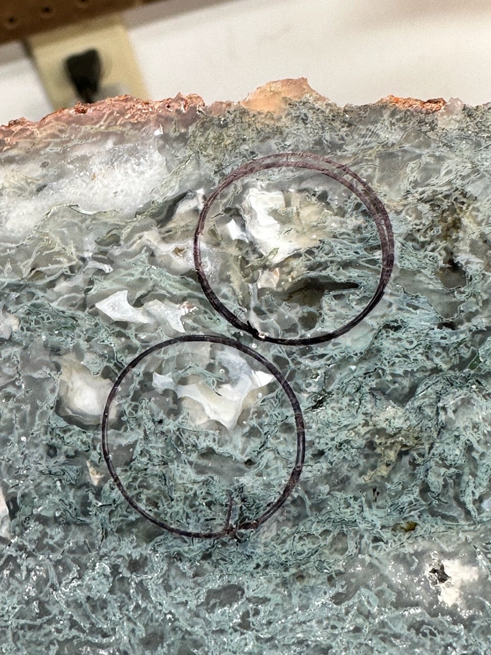

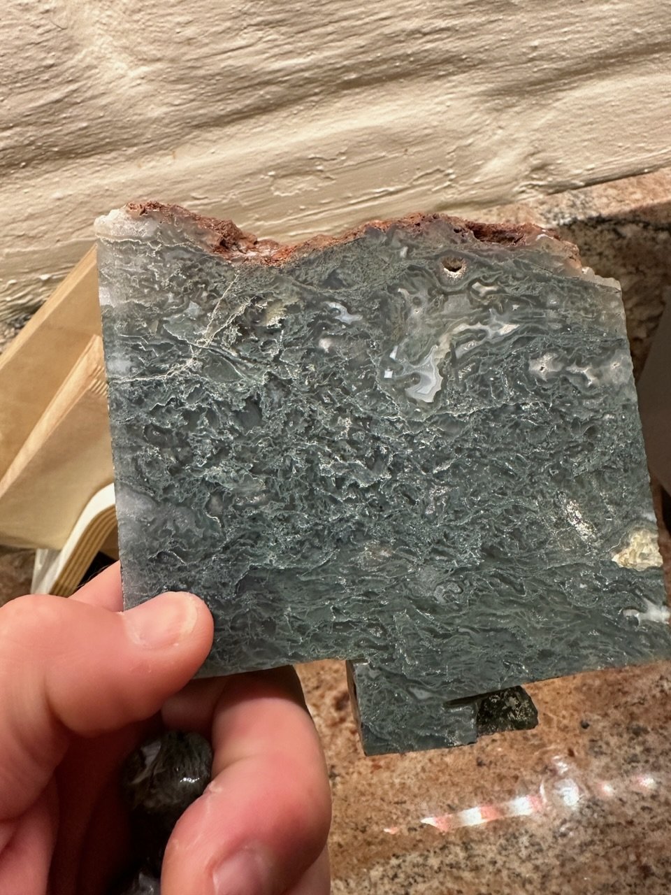

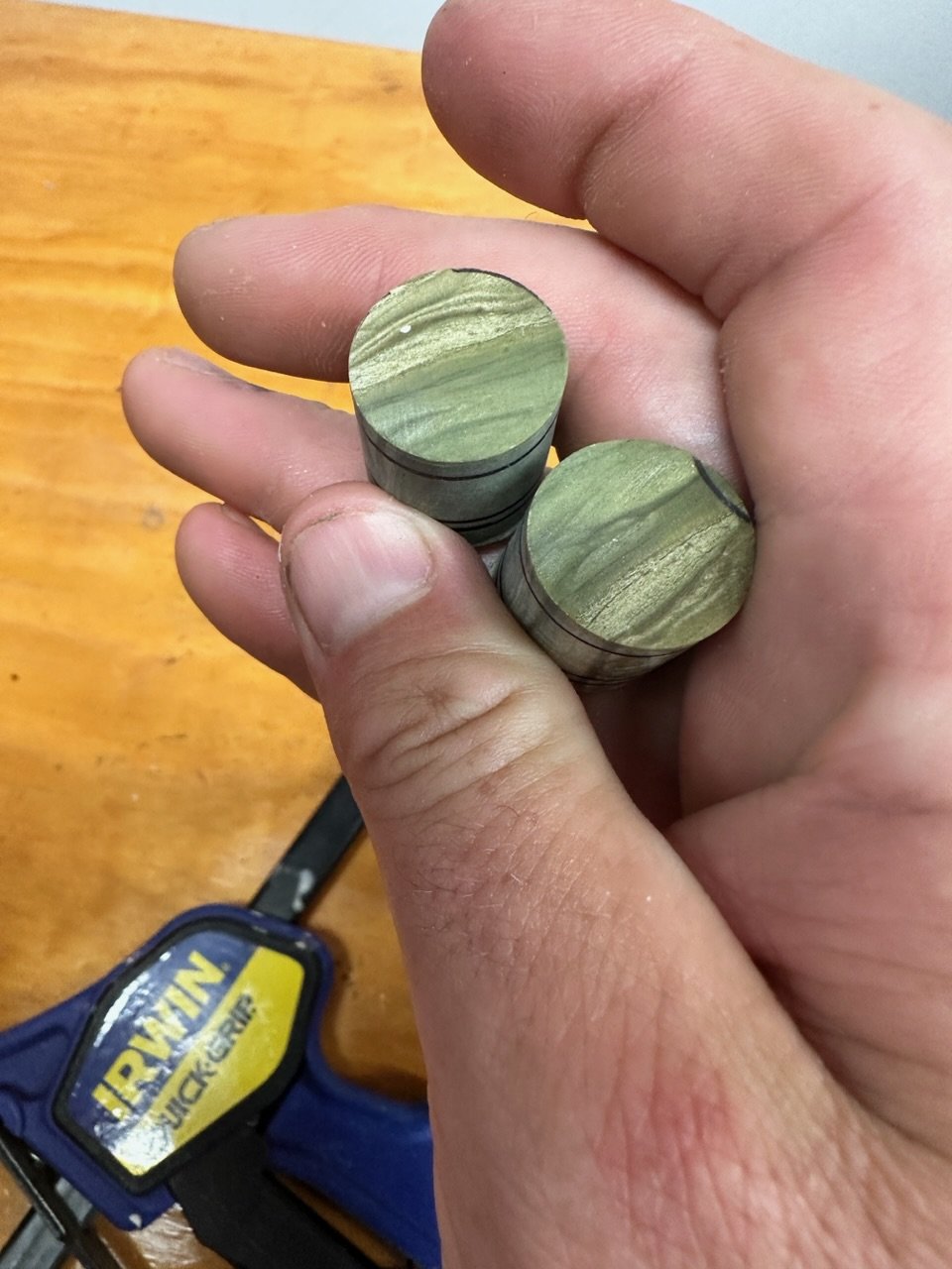

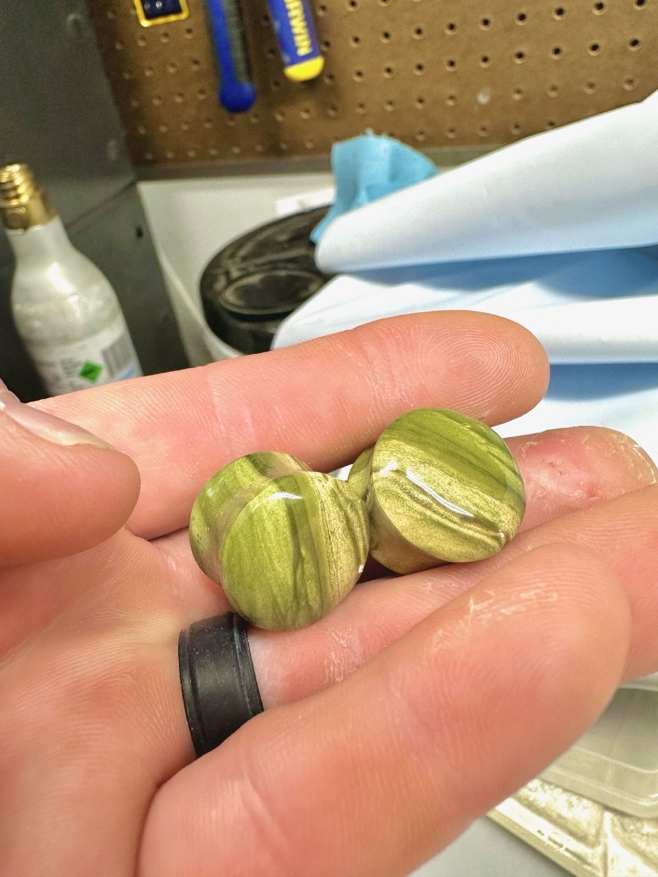

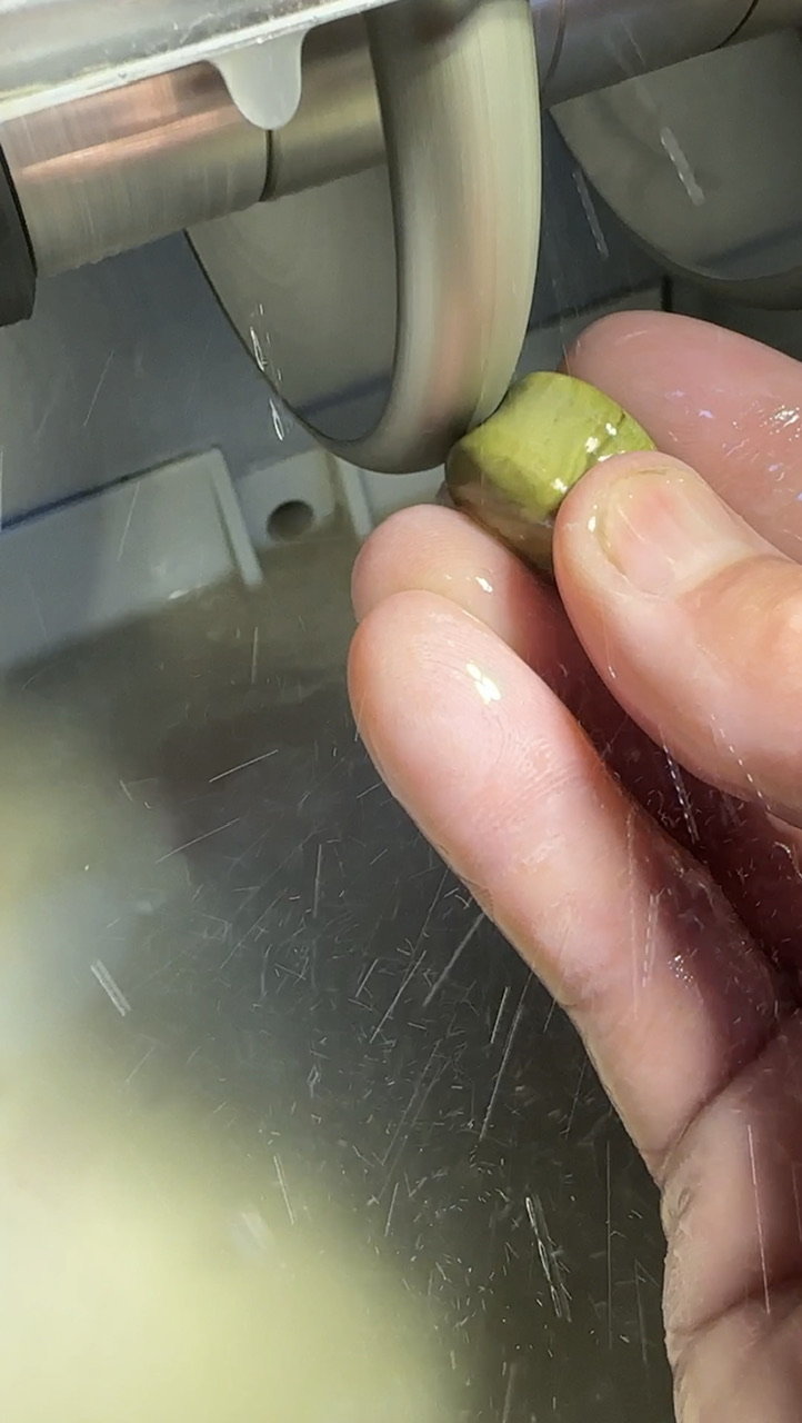

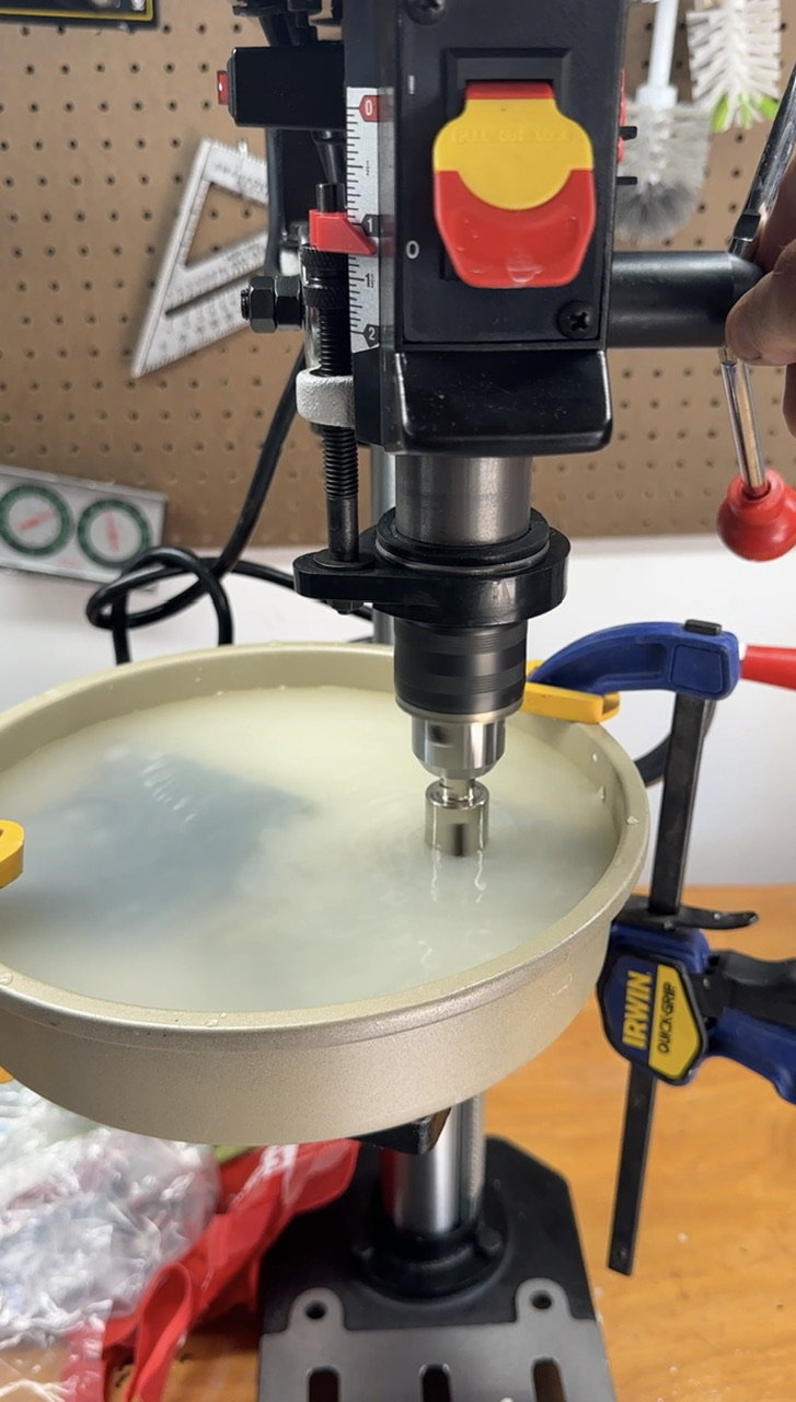

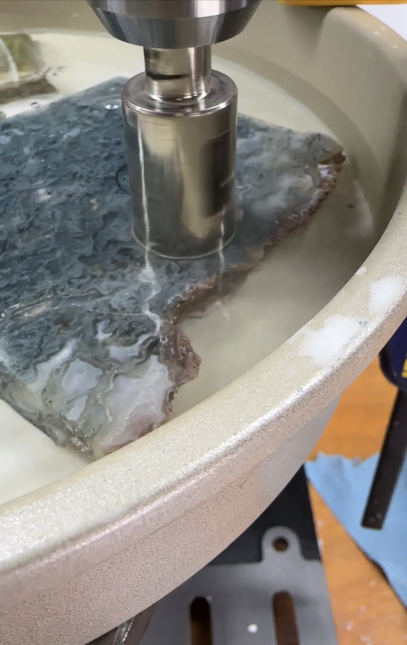

    Not what I did for my truck, but what I’ve been up to in the garage recently

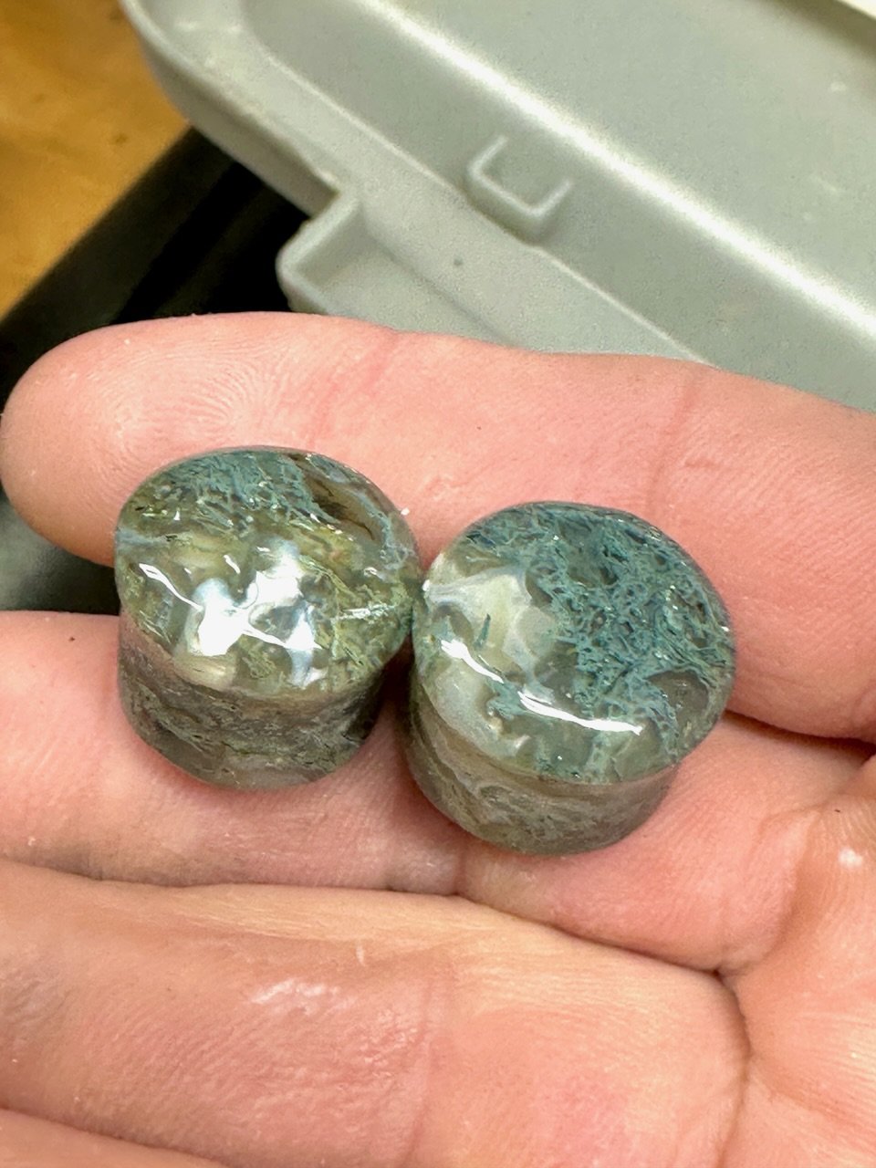

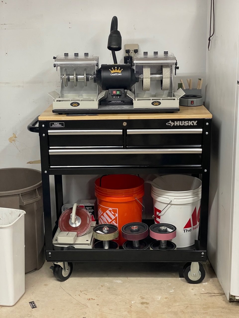

    Got myself a lapidary cabbing machine and cheapo drill press recently to make myself stone earrings (plugs) recently.
    In ear pic for all you fuddy duddies who dont know what plugs/gauges are. I’ve have ~5/8” hole in my ears for 20 some odd years. I’ll be a cool old man with saggy ear lobes some day.

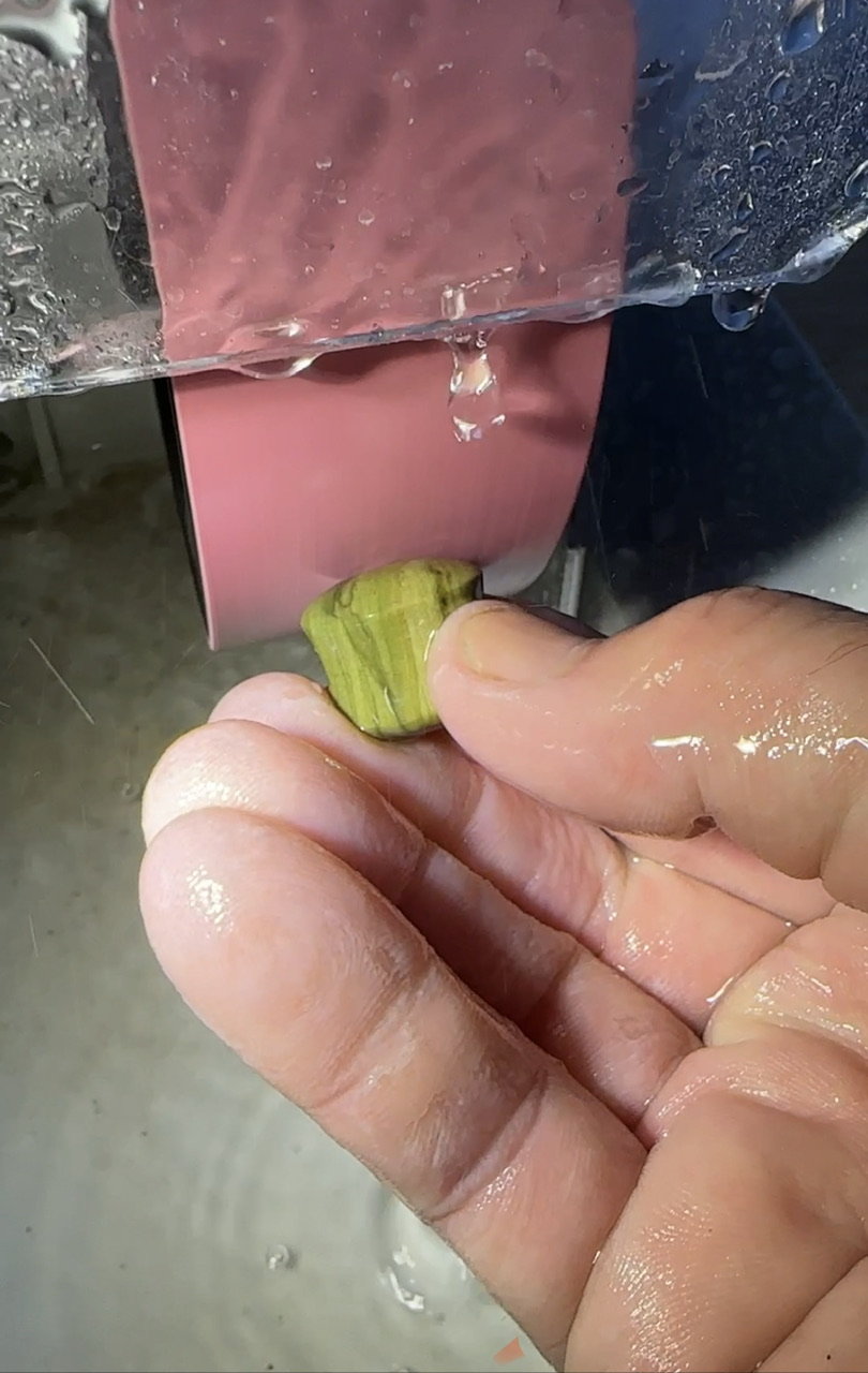

    Get the stones cut into thick slabs. Place it in plaster of Paris in a cake pan. Once it sets, put it under 1/4” water to keep the diamond core bit cool. Drill out the cylinder. Grind rounded faces, grind out the saddle, polish it all. Have diamond embedded wheels that are 100, 200, 280, 600, 1200, 3000, 8000, 140000 grit.
    Different stone but same idea
    Lizard stone jasper
    moss agate

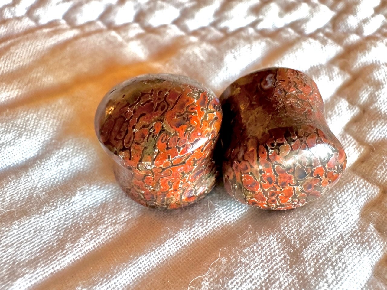

    Agatized dinosaur bone

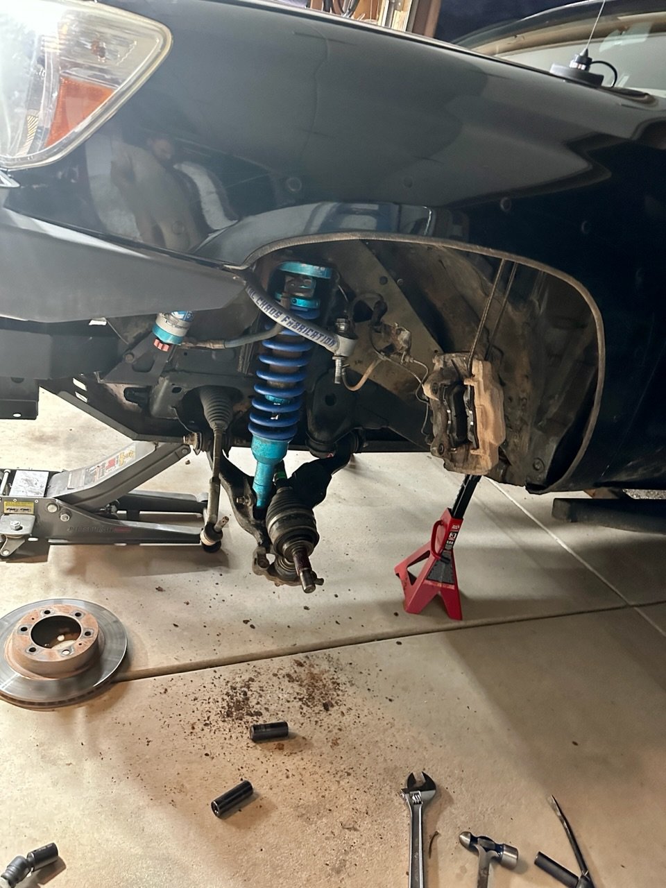

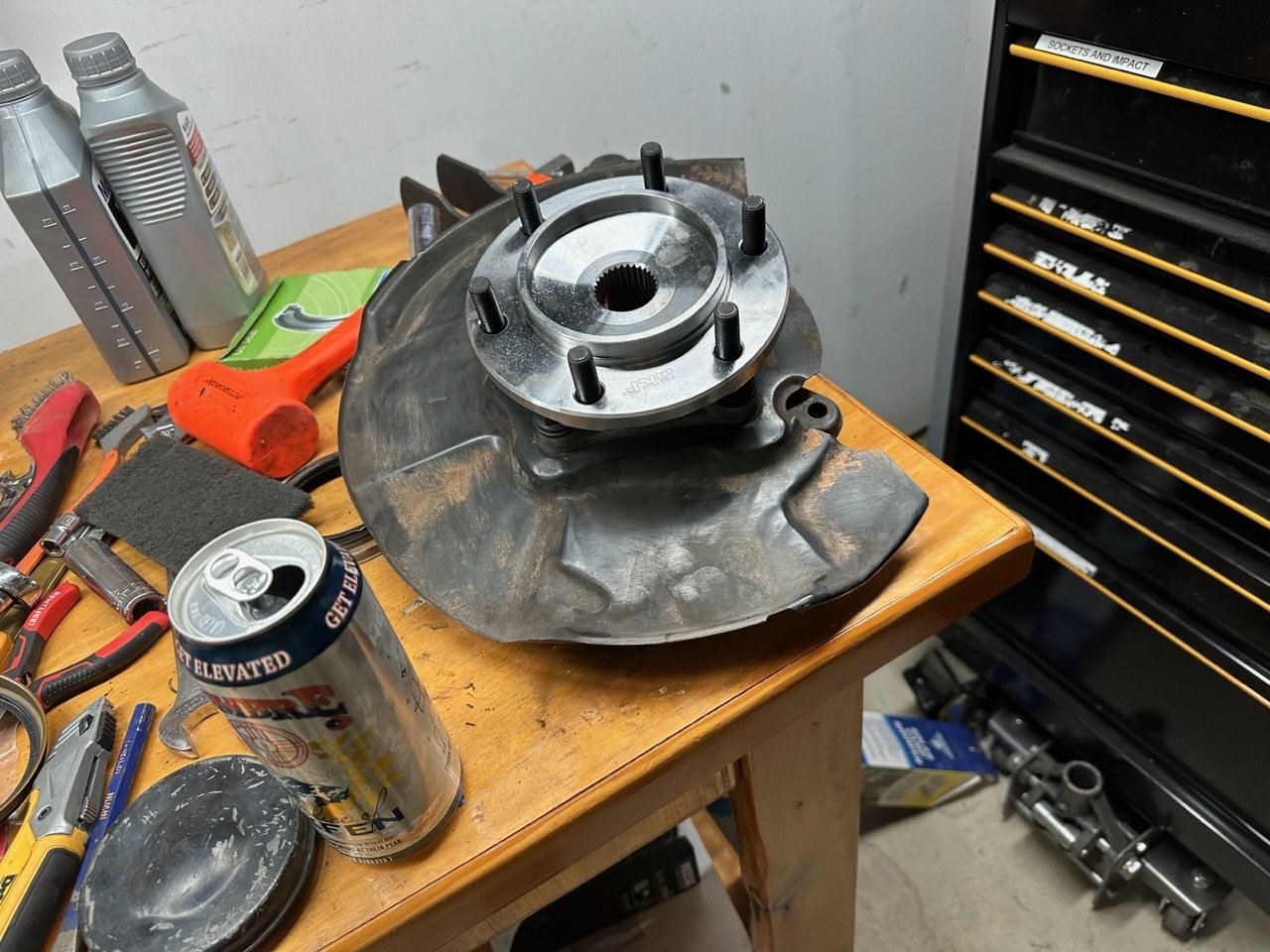

    At 180,000 miles, with something like 1500 miles of dirt this year, feels like all I do these days is chase rattles, squeaks, and clunks. And endless maintenance.
    This time it was a wheel bearing. New hub assembly it is.

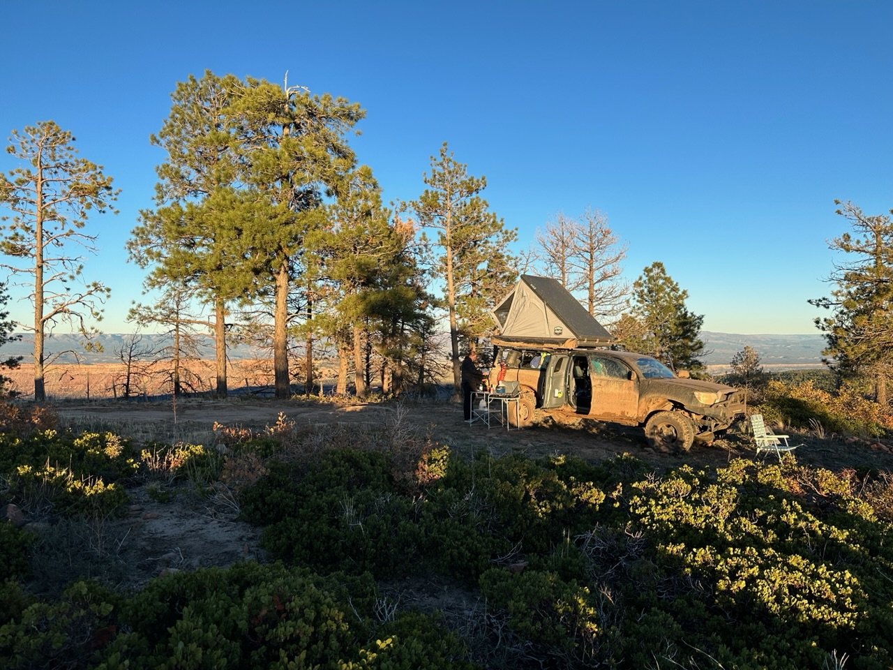

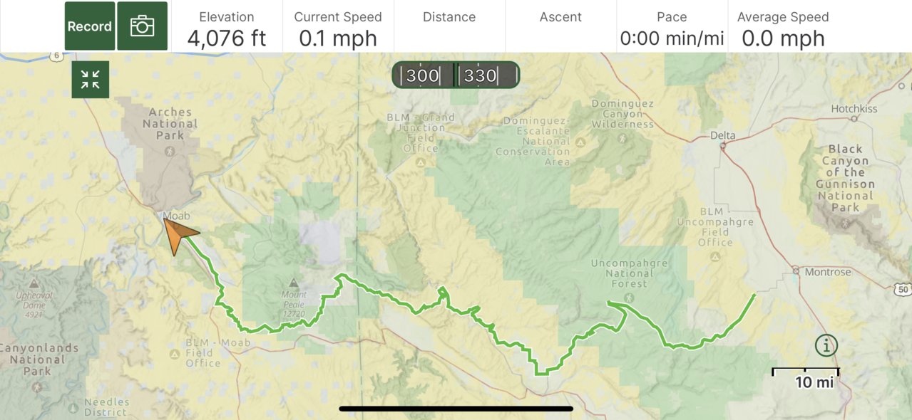

    Well another trip to Moab in the books. And to quote my wife “That was really lame wasn’t it?” And the answer is yes.
    We had reservations to camp an few nights in Canyonlands, but she had a work trip pop up so we changed plans and ran the Rimrocker Trail from Montrose, CO to Moab.
    And to be honest it was quite bland. Lots of really easy trails, some pavement. And the end towards Moab was super bone-rattling rocky and over grown. There are prettier trails in the Uncompagre, and probably 100 more scenic trails in Moab.
    We ran it. And found a cool camp spot, but I will not be running that trail again, nor actually even recommend it to anyone.
    These two were the highlight of the trip
    Otherwise it was fine but not amazing.

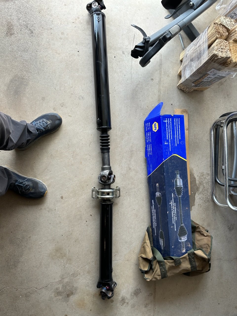

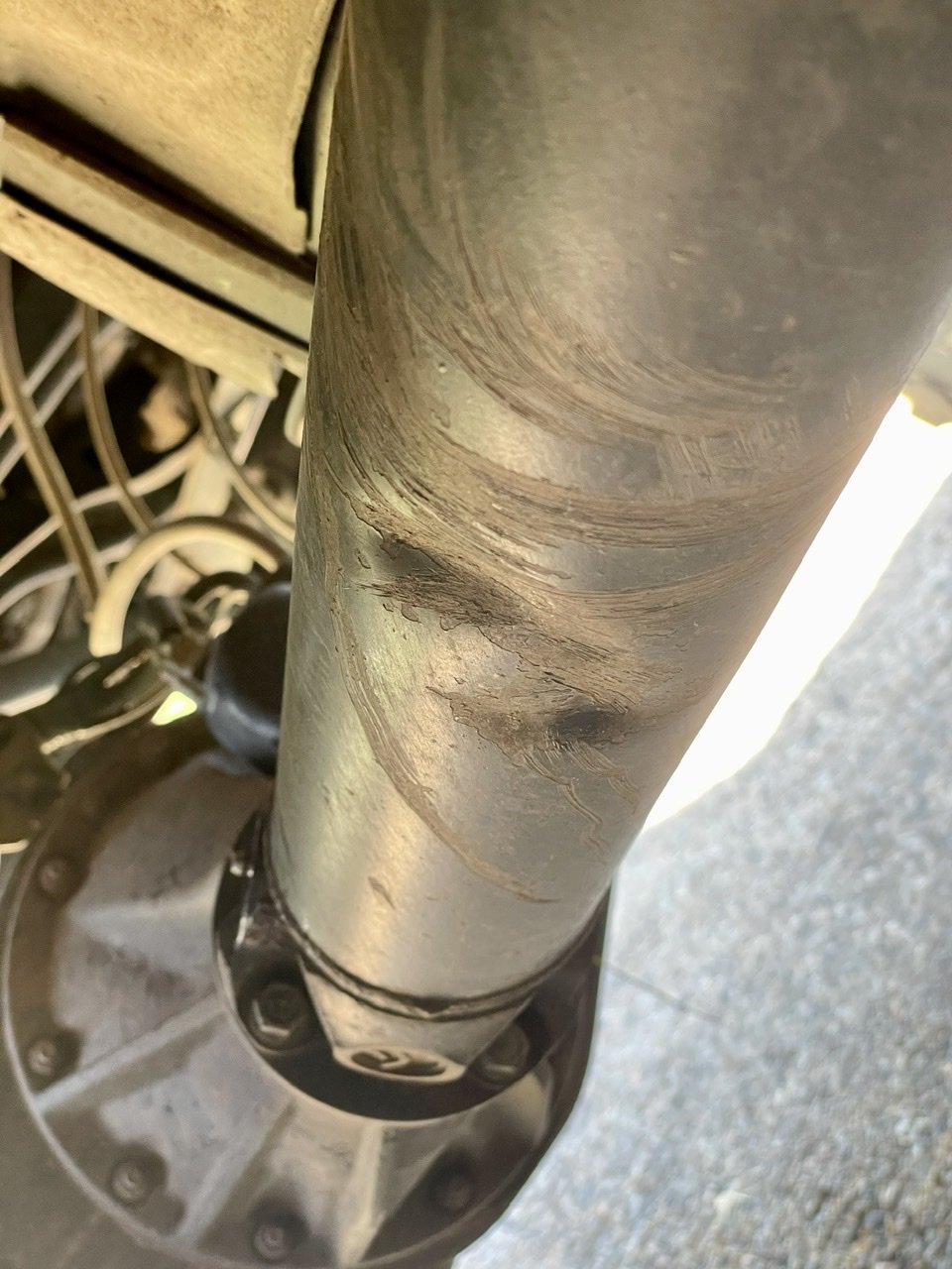

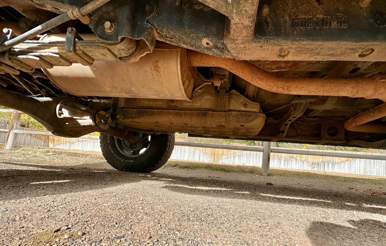

    Installed the sweet new Bluetooth rear driveshaft! So clean, like those amazing SEMA show trucks. :rofl:
    Or had my driveshaft rear tubed because I had apparently given it a few little love taps.
    To this:
    When I got it back, I replaced the carrier bearing and ujoints.
