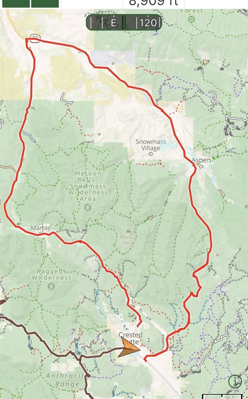

    Jeni and I went up to Crested Butte Colorado for the weekend. Did Pearl Pass from Crested Butte to Aspen, drove around to Marble and then Crystal River rd and Schofield pass. Proper off-roading on Pearl Pass, maybe 4 hours, really rocky and 2 proper obstacles. Crystal river road was rocky but fine. Schofield pass (with the devils punch bowls) was pretty technical, so damn narrow and rocky. And ran into a Toyota group. Split a side wall and had to do a trail tire swap. Good times.

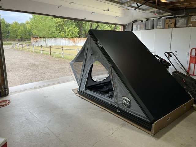

    When we decided to get a roof top tent, I new I wanted it to be fast deploy and able to hold the bedding and as light-ish and low as possible, but able to carry the kayaks if needed too, since we love kayaking. So we settled on the two channel CVT Mt Hood medium.
    But when I ordered it, I knew I was gonna pull my Front Runner roof racks and just use two 48” 1020 8020 extruded aluminum slats and low profile (1/2”) feet from prinsu. Apparently I had it in my head that they came in sets of 4 or something so the week of our Moab adventure
    the shit arrived and I didn’t have enough feet. I needed 2 pairs of feet from the load bars to the tent and 2 pairs of feet from the tracks on my camper shell to the load bars. Since I didn’t order enough, I had to use feet from my front runner roof rack.
    As such the tent was about 4 1/2” above the cab. Which was ridiculous. Those feet were 2 7/8”. The new ones are 1/2” so the tent is now a bit lower which I love. The tent is 1 1/2” over the shortened shark fin antenna and 2 1/2” over the cab.
    But from personal experience hard wheeling I know that bed only flexes about an inch independently from the cab.
    So I may ending up fabbing an even lower profile solution. Although now I can fit my arm under there to check bolts and I may not be able to do that logically with a lower profile set up.
    sparkystaco, Rezkid and Shellshock like this.
