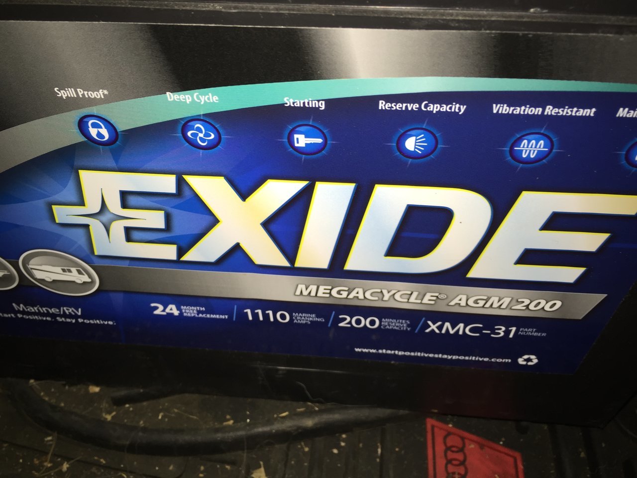

    I have an Exide XMC-31 marine deep cycle in a pelfreybilt battery cage. It's a bit more than your budget, but I have left my fridge go for 4 days, plus charging battery packs and phones, plus LED camp lights with no problems...not even slow cranking. This was a stop-gap measure till I installed a dual battery....may not even go dual till I put a winch on now since this works so well.

    So was the pelfreybilt cage a requirement because the exide didn't fit in the original cage?

    Oh yeah...group 31 battery. Takes every bit of available space where the factory battery was. It's pretty freaking big!

    I picked mine up at an Academy Sports store. I used a locator tool on their (Exide)website to find local retailers, then shopped for best price. I got it for $210 after rebate.
