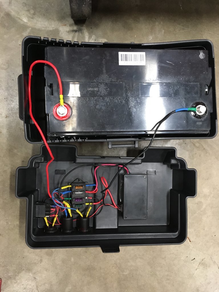

    BED59C63-D545-49E6-B88C-253B45529C59.jpg C3719334-6F56-4B20-9924-B87E8A1DFF0F.jpg my stand alone setup is 2 parallel yellow top batteries making 150ah.
    i have a 150 watt solar, 40amp mppt controller.
    fridge has run stand alone for 8 months. most of the time empty. fridge has never once shut off and batteries have never dipped below 12v.
    everything is left DC. but have an inverter i could run additional items off.

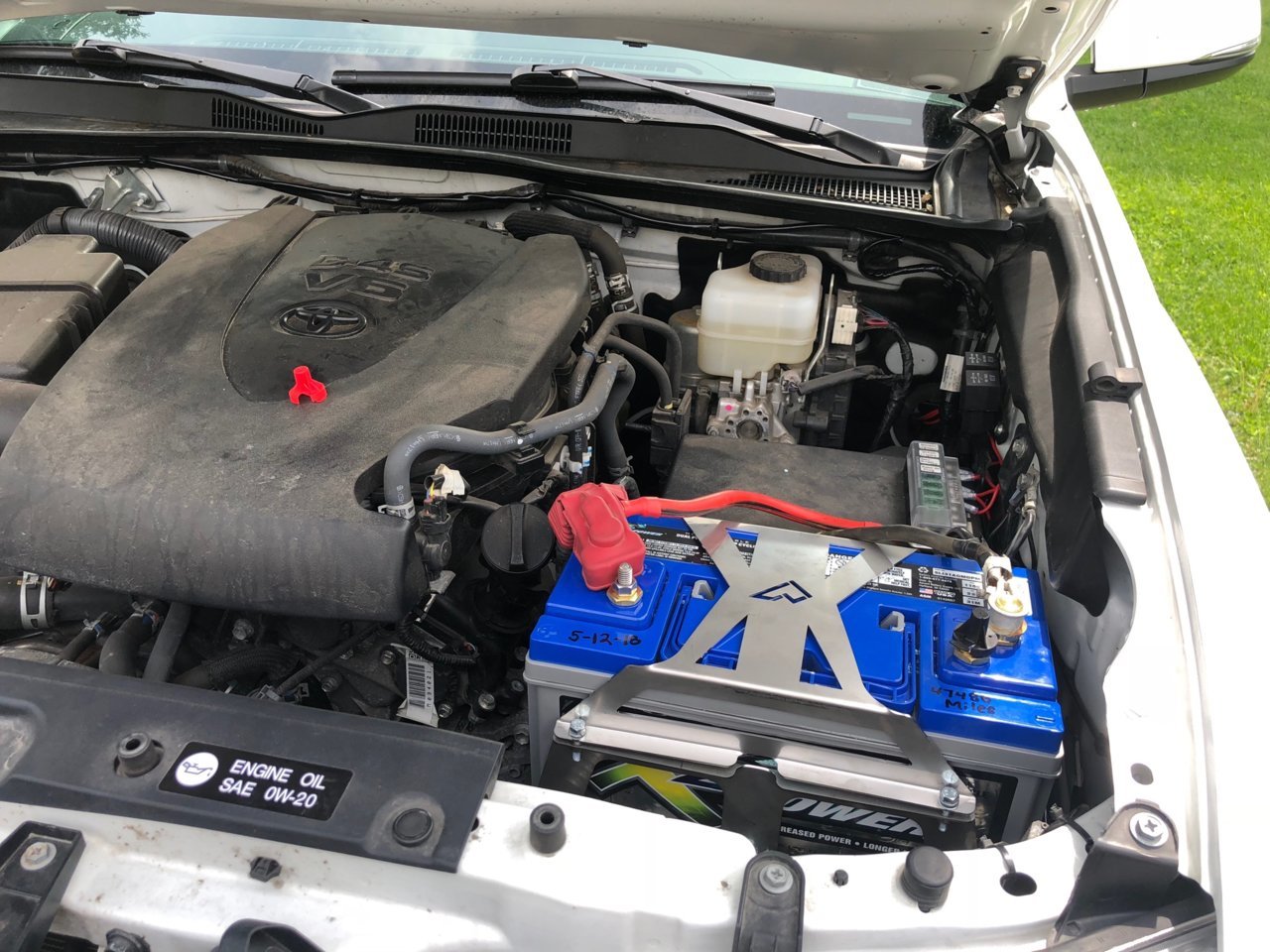

  12. Jul 25, 2018 at 4:59 PM
    #52
    2ayne
    2ayne Well-Known Member
    Oct 1, 2015
    #165609
    821
    Zayne
    Ohio
    2017 Cement TRD Pro
    Yes!
    However it doesn’t look the prettiest and I removed the little cover for the box thing below the battery. I think it just shields the cables from the event of a belt breaking? Maybe?
    Reguardless I drove 100 miles of the white rim trail with my Pelfreybilt cage and all was good. No shifting or anything crazy.
    The cable is tight however but not so tight I was worried.
    I had to put the terminal on a little sidways as you can see in the photo. Hope this helps!
