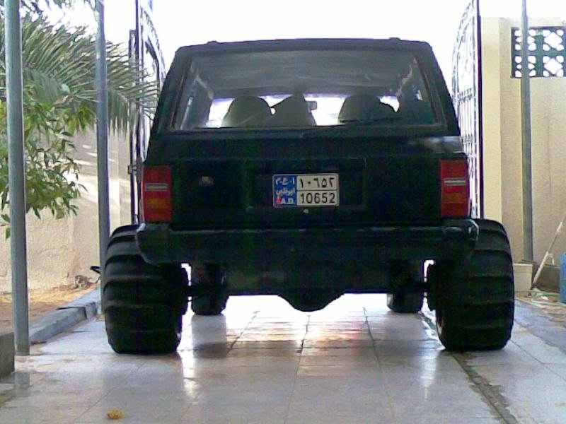

    YotaDan
    YotaDan Dan
    Apr 1, 2009
    #15461
    2,369
    Dan
    Oregon
    FAIL!!

    Yah, if you live in Abu Dhabi and your country is one giant sand dune... those tiire would work... I bet you have a job and need to also drive on roads and highways!
