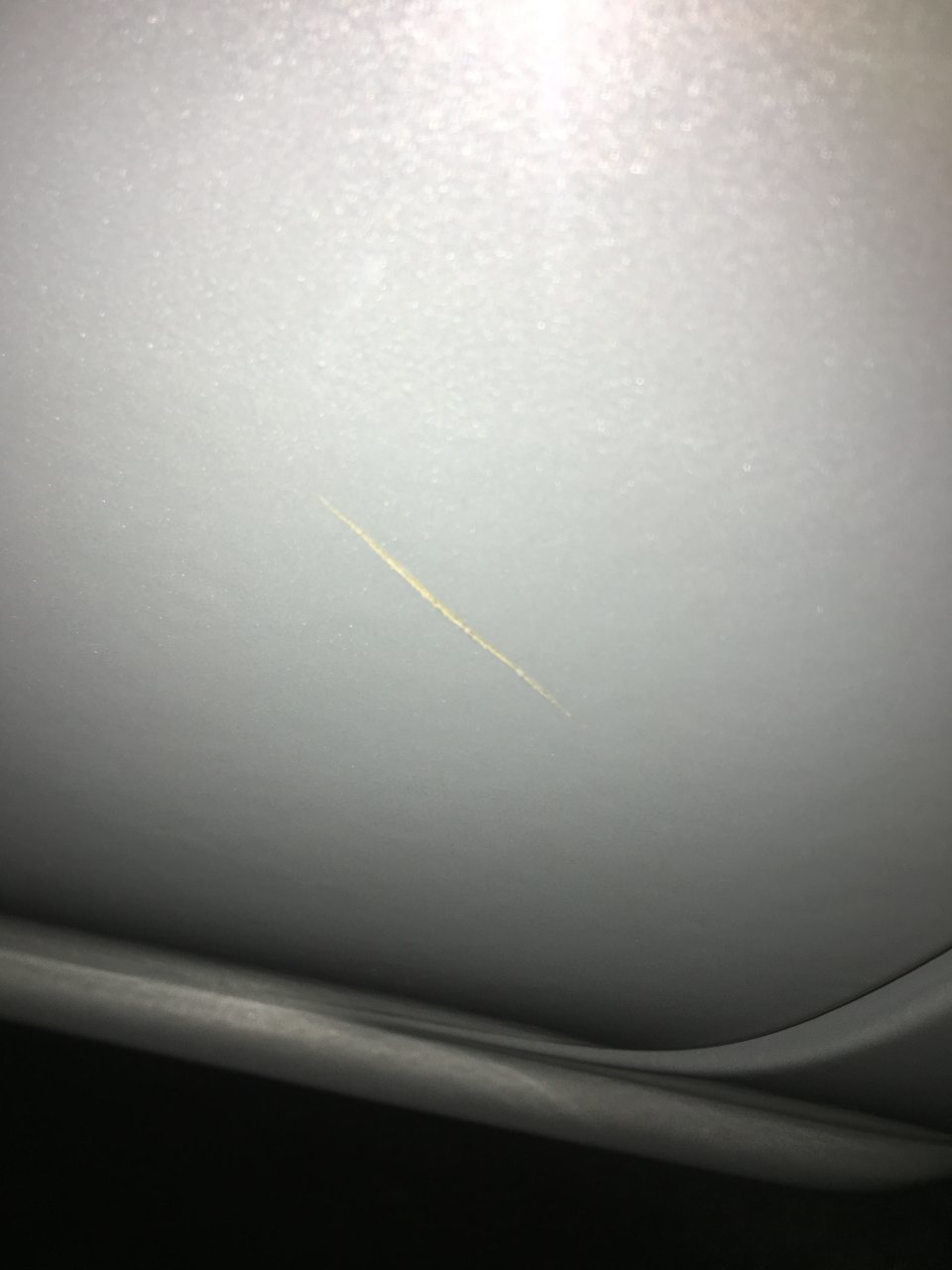

    Noticed this when walking around my truck today, fingernail definitely fits in it. Looks like it’s all the way through the paint. I’m assuming this is going to need some paint work done.
    Any suggestions for treating a scratch like this?

    It looks by your avatar you run in the dirt. Just touch up paint and clear coat it. You will be getting more

    Dr. Colorchip works great on not only chips but scratches as well. I would clay bar it and use the kit stated. You maybe have to layer and blend it but it should look good as new in no time.

    Sounds good, thanks for the advice and kit suggestion.

    Toothpick and touch up...one run only so it’s not patchy.
