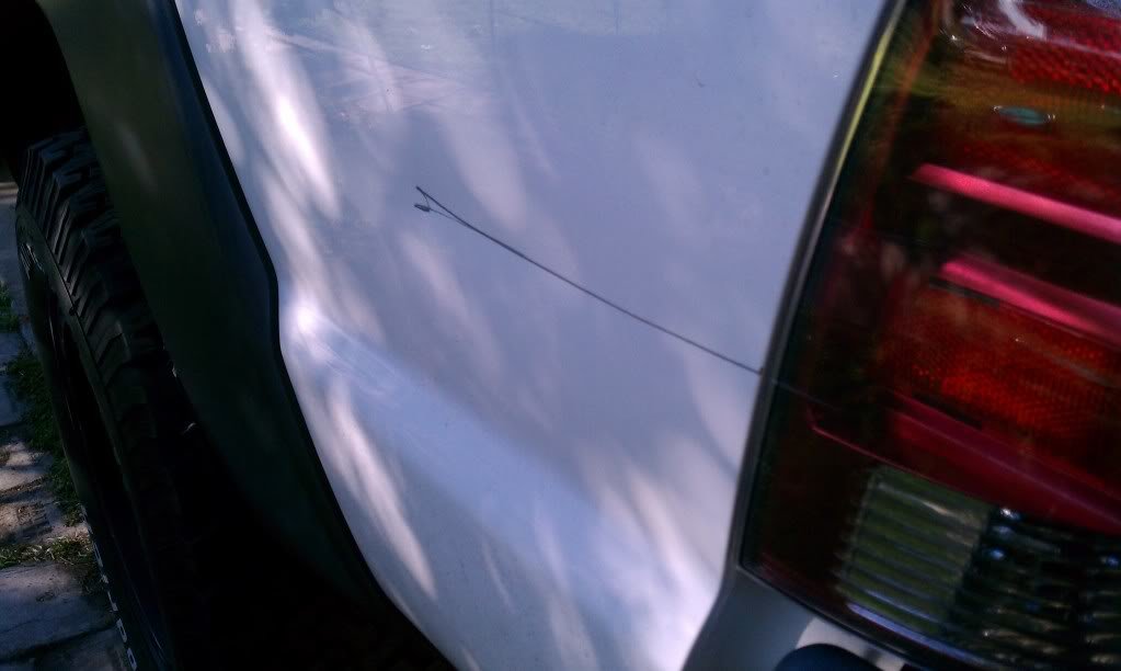

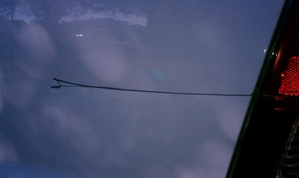

    Ok figured out how to post pics....easier on my phone lol...yea well thats the nasty scratch...the triangle part scratch is were the small dent is...looks horrible right? I mean hopefully my small project ( dupli color kit ) can cover it up...

    You will probably not get the dent out, and my experience is that the color will not match perfectly, although white is one of the best colors to match. I have fixed many scratches on my vehicles over the last few years, although nothing as big as your's, but to me the most important thing was to make sure that it gets sealed from the elements to keep it from rusting. Hopefully the white will be very close. My wife's van is white, and I have been able to get pretty close, but it is still noticeable, but if you rub your fingers over it it is completely smooth, so at least I know the paint is as thick as the original.

    Yea...lucky to have a white truck....kinda nervous about rusting....so tomorrow ASAP I will start on this project... :(
