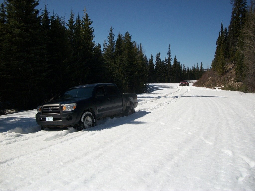

    Not stock sizes, but tall'n'skinny LT235/85R16's, I've aired the fronts down to 12Psi in deep snow. We drove into an area on top of very crusty late season snow on a cool morning, thinking because the road was shaded we'd drive out the same way after an hour or two. Not to be - we sank into 20+ inches very quickly, Even my brother in his Toyota pickup on 33's aired down all around with ARB locker was floundering badly. In the end, I chained up the rear, and aired the front way down to help it float, and took lots of runs at it to break trail and get out about 3 kilometers. Lesson learned. So yes, 10 or 12 will work, but don't steer while stopped.

    Funny, looking at that picture shows how much sun that road ACTUALLY got - LOL. We thought we were going to be there 'till she froze up again that night, which would have been bad as we both had our young boys along.

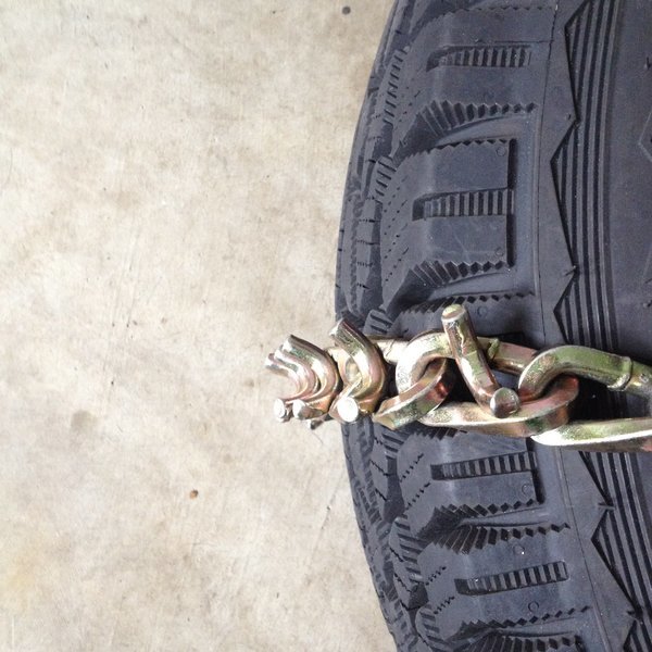

    Bah - Those aren't chains. These are chains.
    For what it's worth, I leave the tires aired up when I run these U-bars.

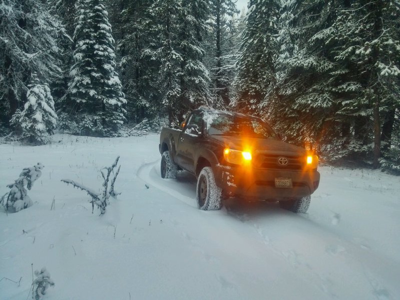

    I've been running with the MasterFlow MF-1050 compressor for about 7 months and it's been one of the best buys I've made. I should practice re-seating a bead in the driveway though.
    Here's one from two weeks ago!
