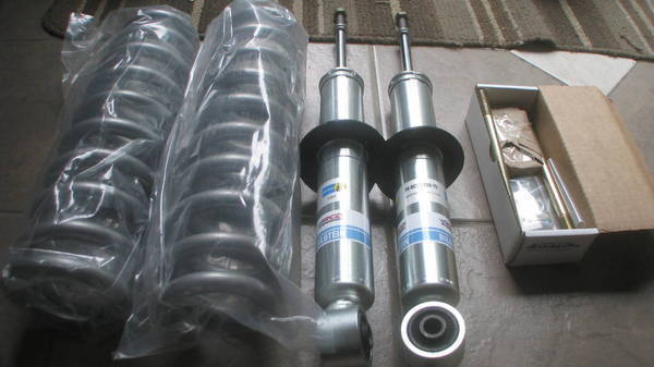

    I just received these! Really stoked to put them in. Eibachs and 5100's
