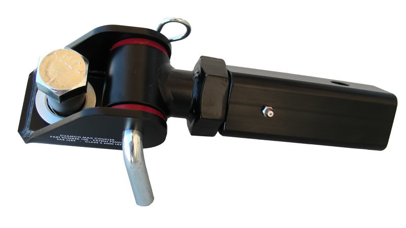

    This is a serious question, as I am working on my trailer build as well....
    Perhaps it is not your intent to truly "off-road" with your trailer, so it may be a moot point. Why did you go with the 2" ball for a hitch? There is such a HUGE limit in vertical travel with a ball type hitch. I am building mine with a clevis type hitch, identical to the military style. The articulation with this type of hitch far exceeds the almost zero articulation of a ball hitch. So I am curious why you went with the ball.

    Something like this?

    Check the build thread.
    I would not spend this kind of money if I did not intend to "offroad" it :D
    If you look down the build list it lists a " Multi-Axis Offroad Hitch ".
    For insurance/business reasons companies have to deliver these trailers with a standard hitch. After I take delivery I will be changing it out myself. I guess I could have just left that part off but that's how I am getting it and then more modifications will be happening after that.

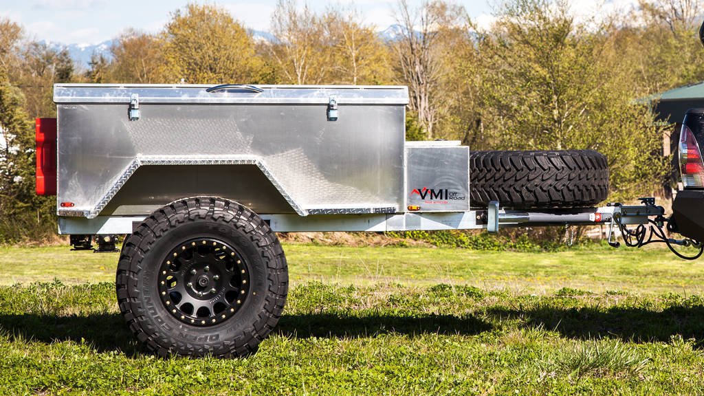

    Progress has been made.
    I will be picking up this bad girl on Friday!
    After using it for a few months I will be giving it back to VMI to install more goodies that will include water tanks, power and what ever else I can come up with that I might need or want :D

    I am going to paint the fenders black to match the truck and just clear coat the "box" to keep the aluminum look. The lid will get wrapped the same as the truck. I will also being going to an aluminum PackRack and clear coating it also to match the trailer more. I like the idea of showing off the aluminum a little bit - its what makes this trailer so damn cool lol

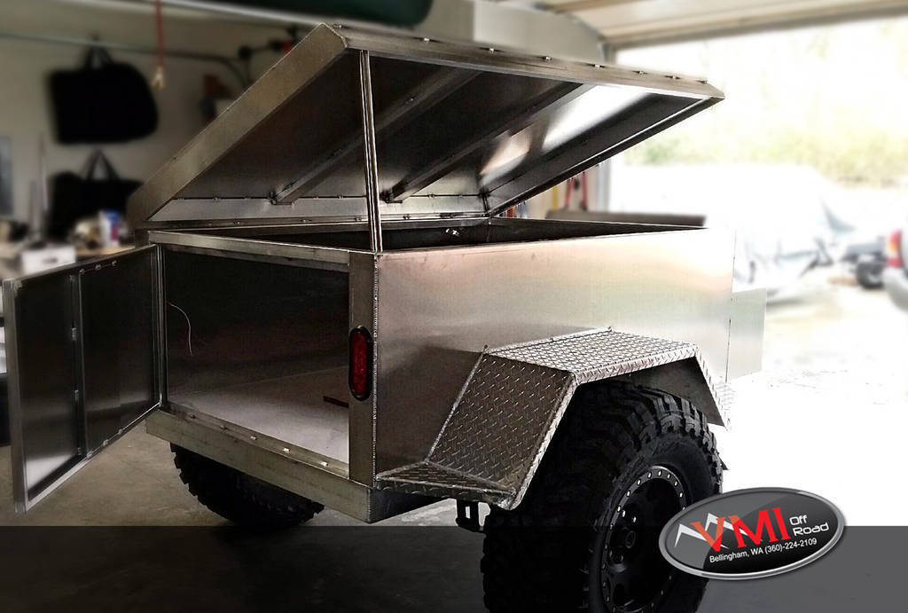

    This just happened!!!
    She is all mine! Well, until I get all the extras like the hot water tank, heat source, comm etc and then she will go back to VMI for all the finishing touches which will also include side entry doors powder coated black etc etc :D
    I changed my mind on the spare tire mounted on the rear door.. too much weight back there and none on the tongue - so I had to be logical and change the plans a little for now.

    This base trailer starts at roughly $10k with a 31" tire combo - it normally has a side entry door and a bulk head included but I didn't want to do that yet until I figure out all the extras I want to add so that I can utilize the space the best possible way.
    This will be going back to VMI in a couple months when I gather all the parts: hot water tank, inverter, comm, on-board air, heat source, radio etc to install it all and at that time powder coat side entry doors, lid and fenders. This will be a full on build with every option I can think of lol
    The weight of this trailer is about 900# which includes the heavy wheel/tire setup weighing approx 110# each. So the trailer weighs under 600# by itself. All aluminum with a 2x4 aluminum frame.
