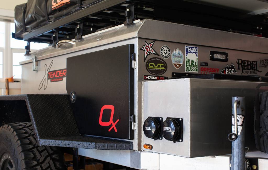

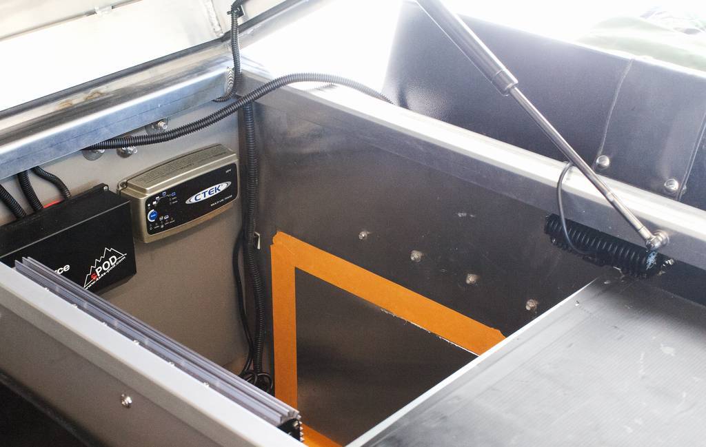

    I've been cutting a lot of holes in this thing lately...
    Main focus right now has been on getting the Truma Combi4 mounted, plumbed then of course working!
    I decided to cut a hole into the tongue box to allow for more room and use that space to run the heat hoses through.
    * wiring is a mess right now while I get everything mounted — once everything is mounted then I will dial in the wiring.

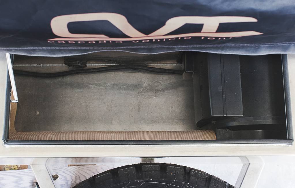

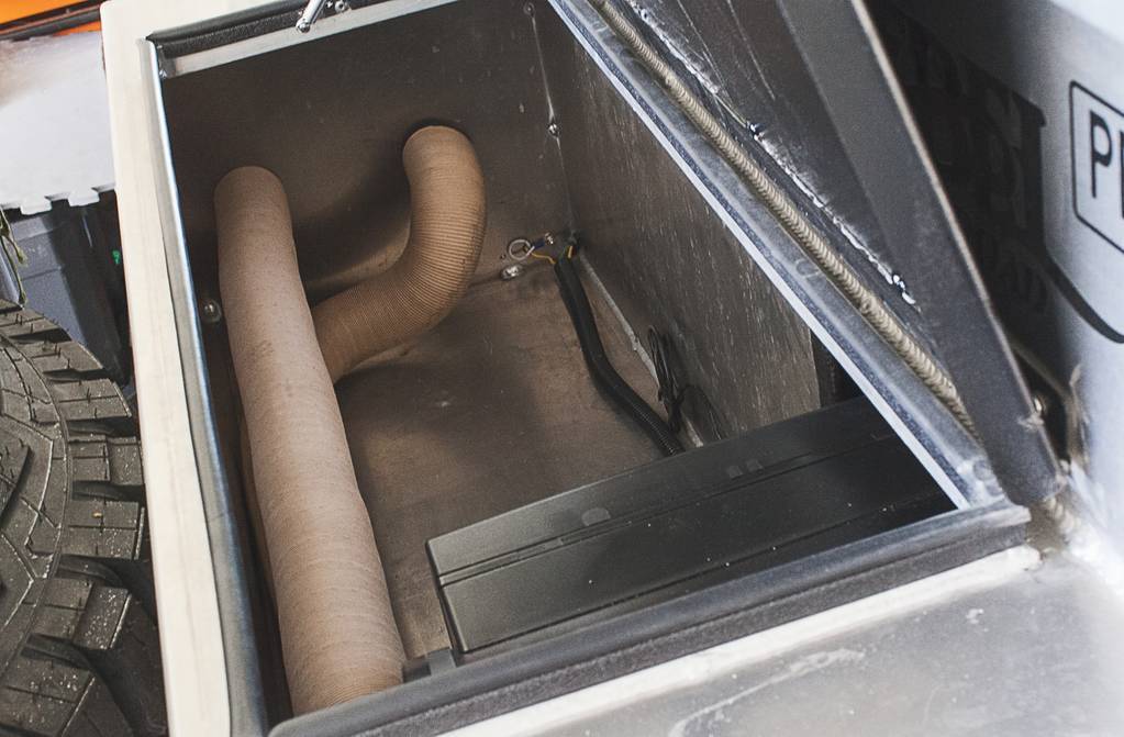

    Inside the tongue box and how the heater hoses will be laid out.
    Before cutting the holes where the heater hoses will be outside accessible.
    I went with 3" RV style bayonets for easy attaching.

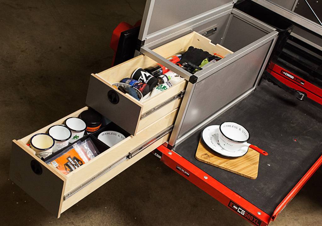

    I have such a mess in GooseGear drawers right now. My OCD goes crazy!
    I am planning on heading over to Colorado to visit TrekPak and have some custom liners made so I can easily change and organize all my crap.

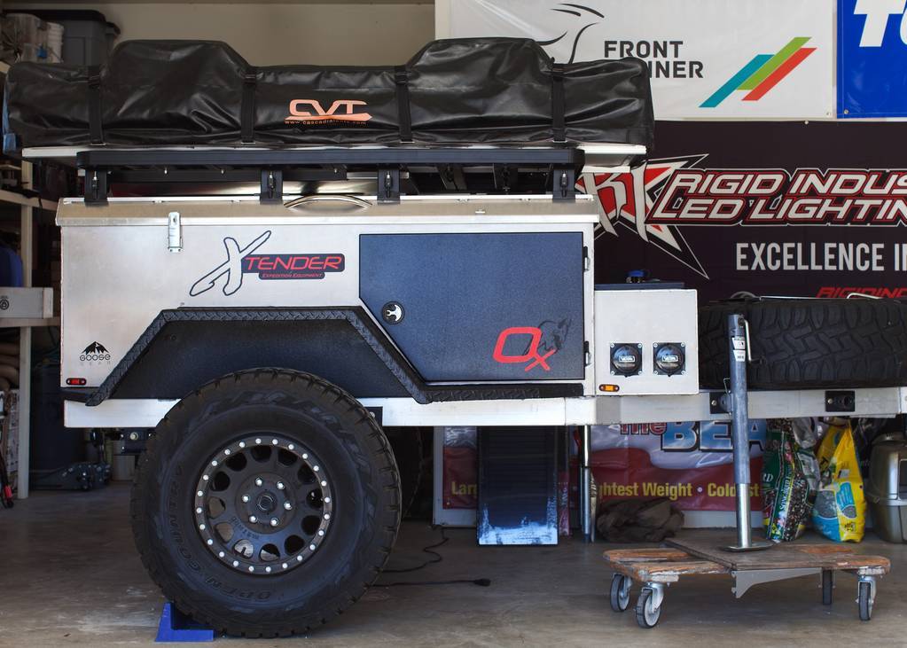

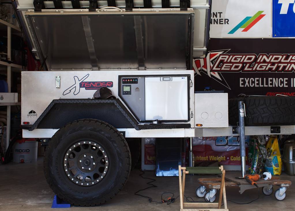

    I got pretty sick so progress on the trailer slowed down but feeling a bit better and going to tackle some more today.
    Some progress:
    _3 Rigid rocklights installed
    _Truma Combi4 mounted and the heat lines ran (2 out the passenger side, 1 out the driver side and 1 into the cargo area).
    Still left to do:
    _Run power to the Truma Combi4
    _Run propane lines to the Truma
    _Cut hole for Truma exhaust
    _Cut hole for propane line access to outside tank
    _Build a bracket & mount 12# composite propane tank to rear door
    _Stack RotoPax cans on rear door
    _Instal the new Timbren Axle-Less suspension
    _Mount ARB twin compressor & tank in the tongue box on a custom platform above the heat lines
    _Clean up all the wiring after everything is installed
