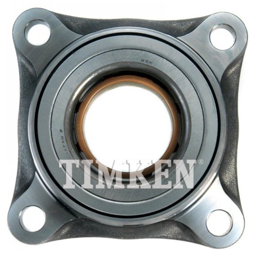

    Not sure how I would add grease to this. It's a sealed unit. I would just tear it apart taking one of the seals off.
    I pressed it in using a drift that only pressed on the inner race
    This is possible. I'm going to try things with a stethoscope (or long screwdriver) to confirm.

    Orange Texas
    2000 TRD
    OME and worth every penny.
    Bamatoys (maybe the other guy who sells premade hubs) shows how to grease them, yes the seal pops out.
    And I think that's exactly how NOT to press it. Should be by the outside with NO pressure on the inner.

    #70618
    2,043
    Mt. Hood, OR
    Mas Tacos Por Favor
    ^^^Yup. If you drive the bearing on the inner race, you can put a lateral load on the bearing it was not designed to take. Only drive/press the outer race, and even then, the bearing can be damaged if not pressed straight and true. If you did in fact drive the bearing on the inner race, I would bet a cold beverage the bearing is toast. Sorry OP.
