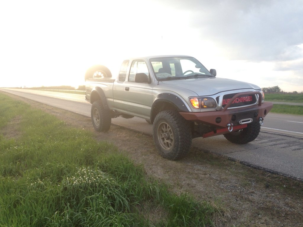

    Woot! My walbro gave out just now while I was hauling 75 mph in the left lane in front of a line of traffic. Almost got rear ended. A buddy with a trailer is on his way.

    Mine turned out to not be the pump. I did the same thing you did and had no fuel come out when I took the fuel line off. Got it off the interstate and pulled the pump to bench test it. It pumped fine. Put it back in and it pumped fine. My guess is the plug wiggled loose, but I didn't see anything obvious when disassembled. I don't know.
    Did you check that your wiring matches the diagram for your particular year?
