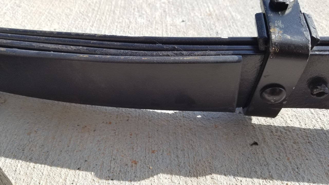

    Purchased a new set of leaf springs from Kansas city spring and an aal from fabtech. See how close the aal is to that u bracket that holds the new springs together? Is this normal? If not, what's the solution?

    Should be fine, neither part should move

    he is probably right but when the leaf straightens out it might hit the bracket. contact Fabtech

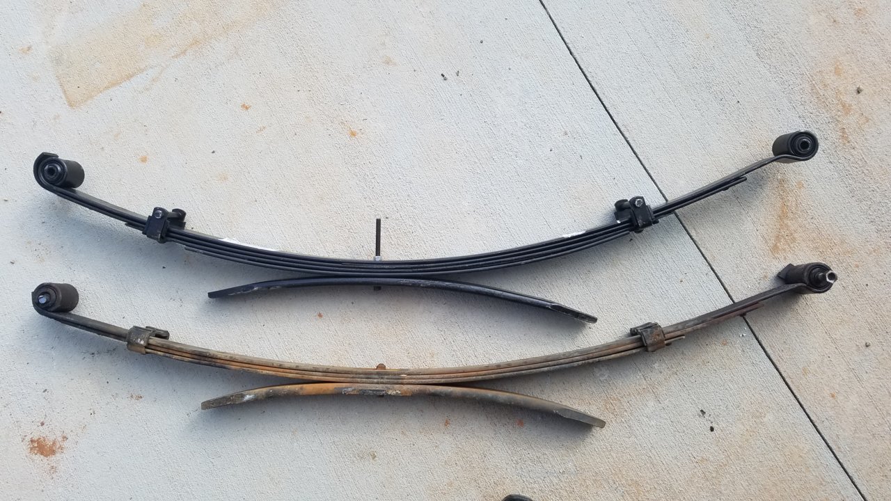

    That's what I was thinking, however, I put a little thought into it and I realized that all the springs will straighten. And I think when the longer springs straighten, the distance that I was concerned about will actually grow.

    That's right the distance between the AAL and the clamp should remain the same.
