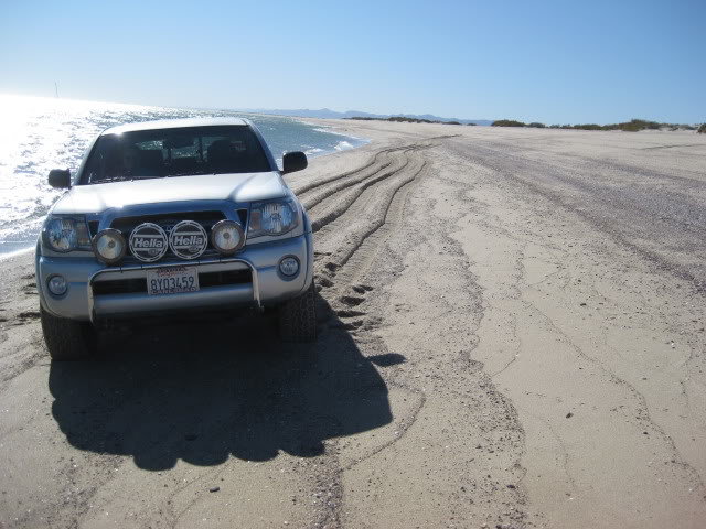

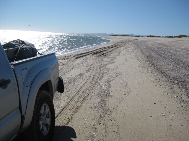

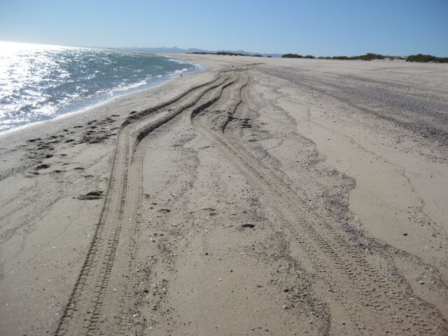

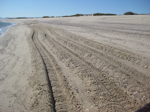

    Last year, I took photos of my Rugged Trails at 32 psi digging into the sand... and how quickly dropping the pressure to 15 psi made them float on top.
    I now have Hankook Dynapro ATms, and run them at 36-38 psi on the street... Did the same test a couple days ago on the beach in Baja...
    This is the gulf coast of Baja (Gulf of California/ Sea of Cortez) where the sand is made with a lot of tiny shell bits. It doesn't compact like pure sand, it just stays loose. So, even in 4WD... and even with A-TRAC... you still need to remove some air to prevent the digging in!
    So, I was able to drive over the dry sand and down onto the wet zone (between high and low tide... it was low tide)... but near the water, you can see how I was digging and slightly sideways at 38 psi:
    I dropped the pressure 50% (to 19 psi), and see the difference:
    Air Pressure is everything in the sand!;)
