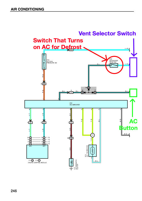

    So I purchased a 1999 Tacoma over the summer and was surprised the first time I kicked on the heat to defrost my windshield that the A/C compressor kicked on. Needless to say, I wanted to be able to run my defrost to clear my windshield without the A/C compressor on. So with the help of several others on this forum I have figured it out and it is not very complicated at all.
    Remove your dash cover around your A/C control unit and once you can see behind the control unit you will see a connector clipped underneath the area behind your vent selector knob. Unclip and disconnect this connector and you are done! Below is a picture of the connector you need to unclip and disconnect. The connector was originally clipped in the hole to the left of it in the picture. I also included a picture from the wiring diagram of the truck, just to show you what exactly you are disconnecting.IMG_20171101_173428982.jpg AC Pic.jpg

    I find it irritating when I want to throw a little air on the windshield and it's already cold outside and then the air conditioning comes on unnecessarily since the air coming in is already the right temperature. Same thing when cruising through rainy weather and all the windshield needs to stay clear is a hint of air running over it. I never use AC (alright there was this one time when it was 100+ at night and I felt like I was driving through hell) so having it turn on when I want to use the defrost is a pita sometimes. Sometimes it would be beneficial to have the AC come on to dry the air out. Then the AC button can be used to turn it on.
    I guess it's kind of like the difference between manual transmission and auto or full auto and the kind where you can select the gears. Some people want more control. It's not something that bugged me enough to do anything about it, but now that someone asked and I saw how the circuit was wired, and now that there is nothing to lose, everything to gain, and I can go back to stock very easily, I think I'll try it.

    Not trying to disprove it either... I just like to be able to choose if I want heat or dehumidified heat. I don't always want the heat blowing on me and set it on defrost so that I have heat but not on me. It is a personal preference.
    If you do not like it just don't do it. You do not have to tell me that the A/C benefits me when I am trying to defog my windshield, because I know this and I can still hit the A/C button to turn it on manually if the need arises. This is simply because I enjoyed the defrost setting on my other truck for heat and did not need the compressor running 24/7 for no reason. I posted this incase there was anyone else also wanting to do this, without having to figure it out for themselves.

    I guess the term "defrost" is possibly complicating the discussion. My windshield is never frosted. I would scrape it too when I grew up in Maine @Madjik_Man, but now it's just to get the windows and windshield unfogged in the morning when the coastal fog comes in at night. The same thing can happen when I'm cruising on the freeway in the rain. I don't need cold air in these circumstances, just air moving across the windshield. In both cases I'd rather have warm air so it gets the cabin to the temperature I'm comfortable in, too.
    I like what @ClevSix said about the 2 Lo analogy - it's not always the best / necessary choice, but at times it is a useful option.
