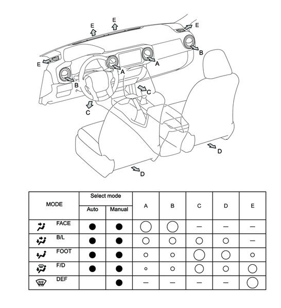

    Do you have the manual or automatic system? I pulled that schematic from the manual section of the service manual, but it does have some ACC info on it. Although, I don't see how it fits in. On the ACC, are the vents split also?

    Auto system, that pesky left vent 'leaks' air in almost every mode but doesn't blow as hard when 'leaking' like it would when you switch to the front vents normally. Happens in Auto or manual control.

    It is the same figure in both auto and manual sections.
    Although from this, you shouldn't have any flow for the last few notches:
