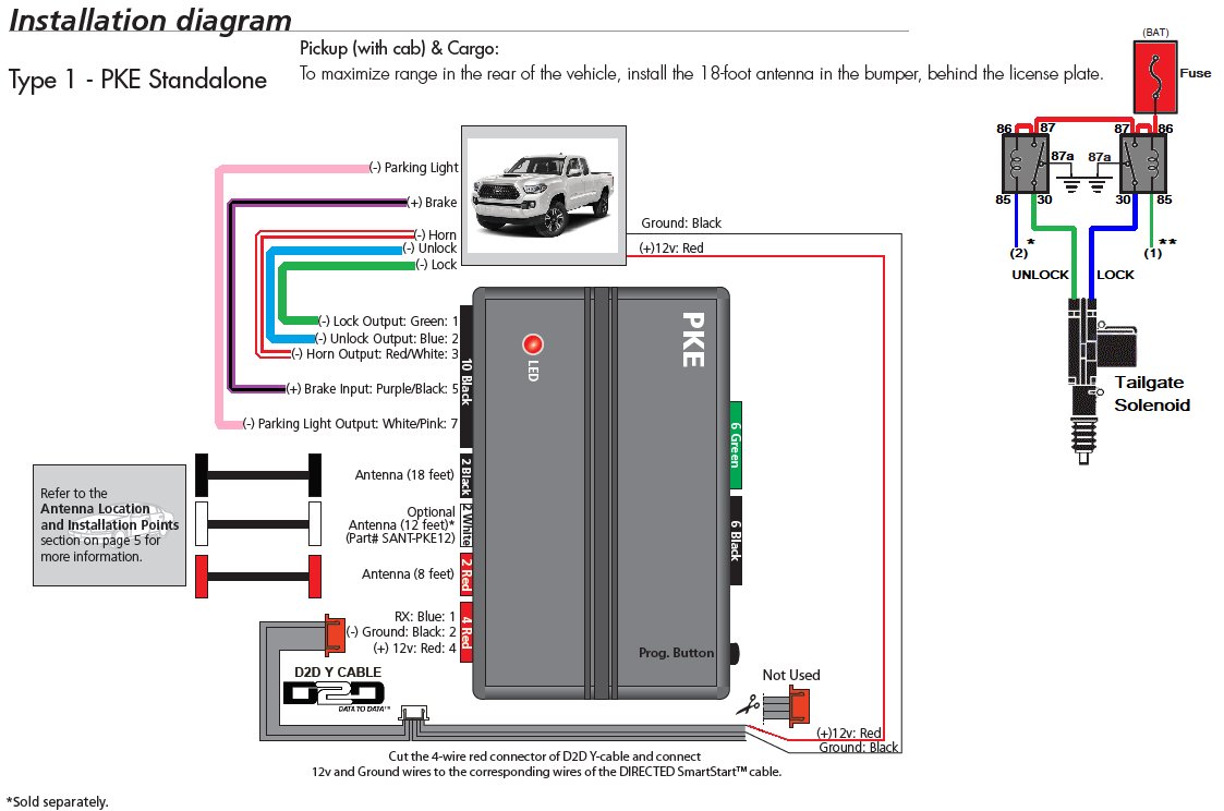

    Anyone have experience with? Chime in, thoughts.

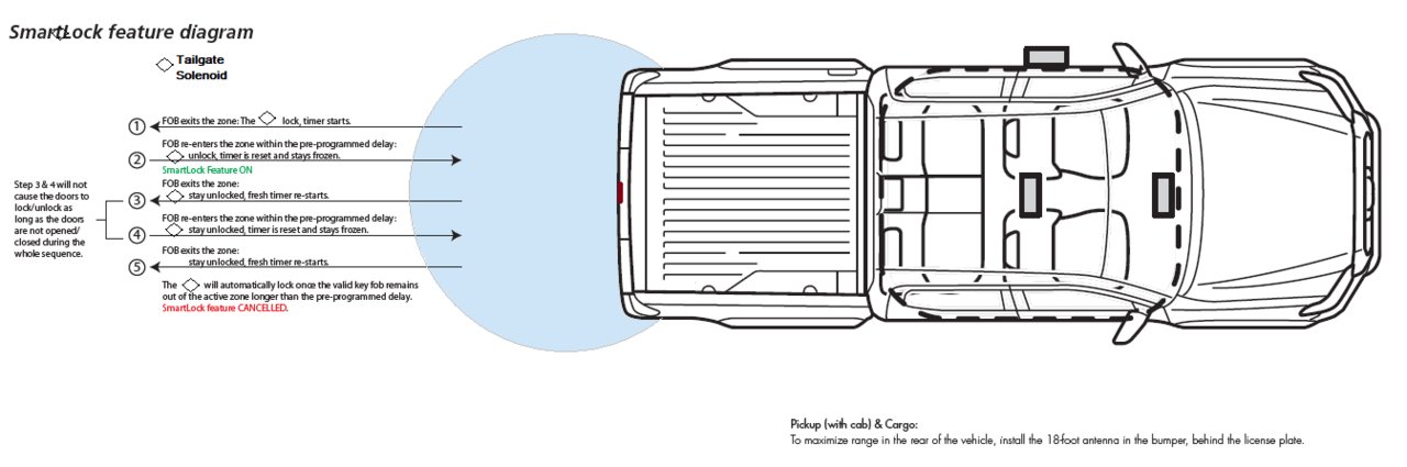

    Info on the system, i.e. reading material:
    And simplified & modified function pic...
