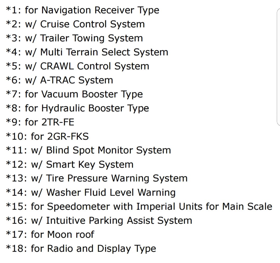

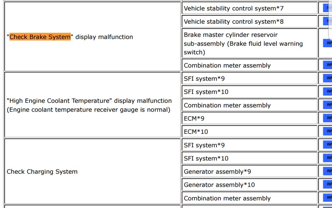

    Yeah, a friend and I went through all the Toyota harnesses that we tapped into. This install has become painstakingly long and has stopped me from completing all the other things I've wanted to do (suspension, audio upgrades, etc.).
    This is what I've found for troubleshooting the "check brake system" error:
