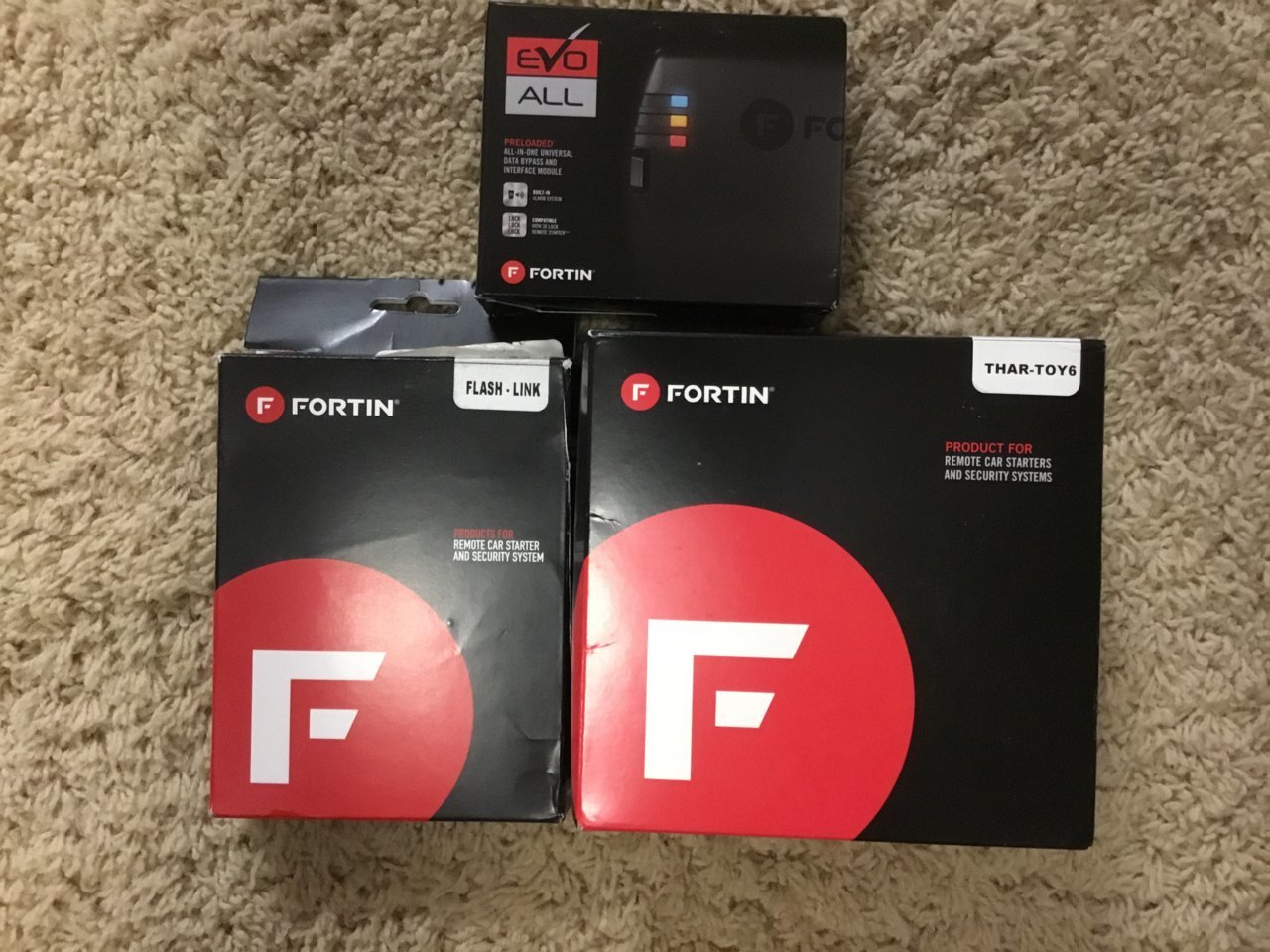

    On my 2016 sport i installed Fortin EVO-ALL and get the Fortin THAR-ONE-TOY6 -Wiring kit, its plug and play , if thats the one for your truck, spend the money it saves HOURS !
    its not to bad to do but the instruction suck , read it a few times and look for a youtube vid,
    i don't use it a lot but it works, had it in for only 4 months or so.
    edit fixed THAR-ONE-TOY7 to THAR-ONE-TOY6

    Had to get them separate / ebay about $75 for the plug , at the time i had a hard time getting the wire set ? sold out maybe? don't know if you can get them as a set.
    I also had to get the Flash link updater to flash my truck info on to it,and change anything else i wanted to, but it was cheeper for me as i also was putting one on my wife's car.
    it was easier to watch a youtube video and then read the sheet. / a few clips and a few screws and snap off a panel or two and your there.
    took longer to set every thing up than to plug it in, plus if i want to add anything i can just re-flash it to suit. just get the right plug for your truck,
    also i used
    Fortin THAR-TOY6 Toyota / Lexus T Harness for Select Push Start Vehicles
    not 7

    I was about to say the same thing, it is the THAR-TOY6 not the 7.81A69CCB-AC66-460C-ABFA-BF41808208B1.jpg

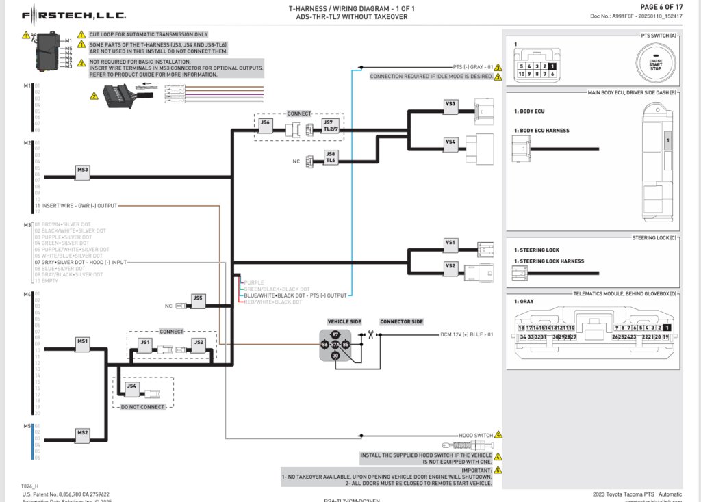

    23 TRD OFF ROAD
    Hello, resurrecting an old thread with new questions, I'm about to tackle DIY Compustar 2way install on 23 Tacoma 4x4OR and the diagram shows PTS Gray at pin 1, I was wondering if somebody knows an alternative location for that wire, can it still be found at Smart KEY ECU? TIAupload_2025-2-15_17-3-40.png
