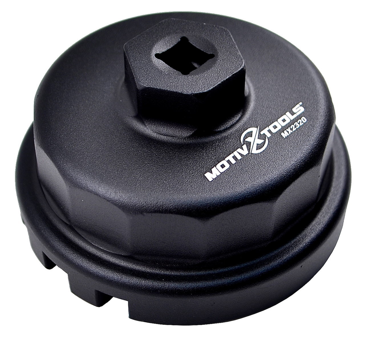

    I didn't use this exact one but I did have one of these adapters. It snapped!

    The cheap ones do that, the motivx is well designed and shouldn't snap.
    MGMDesertTaco and WCTRDTaco like this.

    Ugh why did they change it? The older one is so much better that will grip the little slots. Works way better if they get over tightened… I’ve had the ones that don’t bind together with the housing and then it’s a PITA to get them separated

    Griping with the little slots tended to break the filter housing.

    yep they do break the housing. I purchased a used Rav4 from a dealer and the first oil change I tried could not get the filter off. I used the regular motivx tool with the slots and got the filter out but broke the filter housing. Ended up buying the new motivx tool and works like a charm. (also upgraded the housing to the aluminum one).
