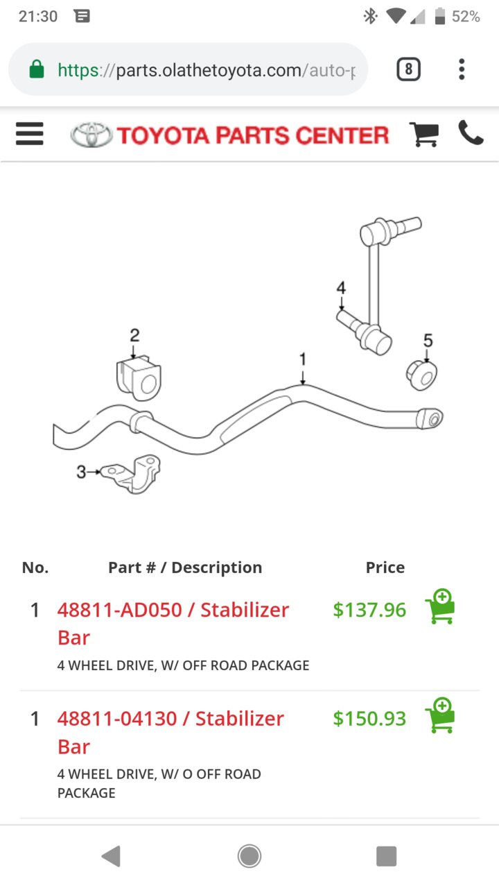

    I bought it used but it had the sway bar. From a cursory look there are 2 different part numbers I found for a 2nd gen Tacoma. That might be for 3rd gens?
    1) PART NUMBER: 4881104130
    2) PART NUMBER: 48811AD050

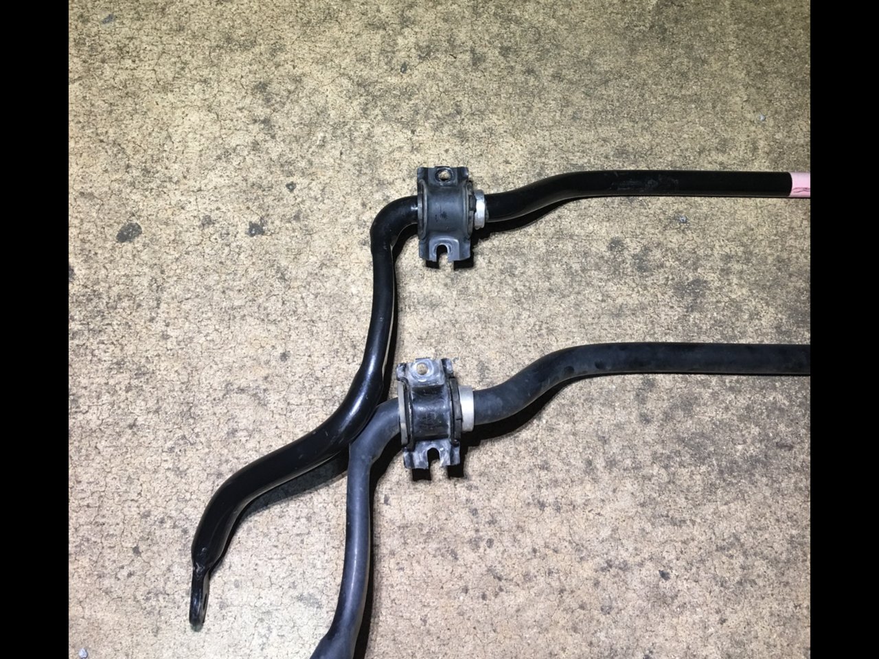

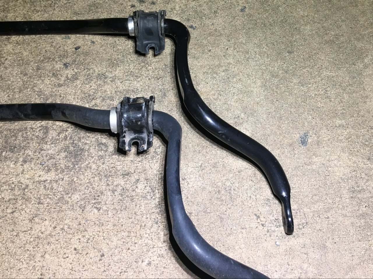

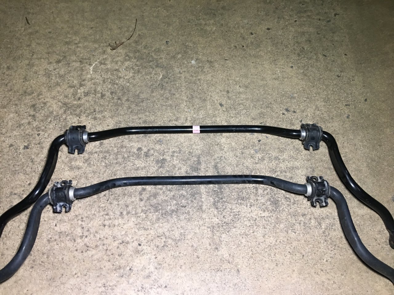

    OR sway bar is 28mm in diameter and the Sport, SR5, and base model trucks all have 30mm.
    Be sure you get the sway bar bushings as well. Hopefully when you find your sway bar it will come with it as they are of no use to the owner selling/getting rid of the OR bar.
    Edit: Actually just swapped mine this morning before Florence dumps rain all over WNC. Also FWIW I just re-used my end links. They seem to be the same across the different trims.
    You can clearly see the smaller diameter OR bar!
    About to go test drive it!
