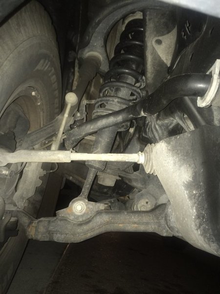

    Umm, I'm pretty sure that is not an optional feature... so yes it is stock. Lemme take a picture of mine

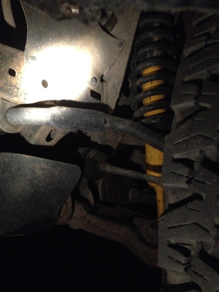

    take a picture of your front wheel well, in the front coilover area. We can tell you if the sway bar has been removed.

    The drifting could be caused by 1) unbalanced wheels 2) need an alignment 3) no sway bar 4) taco lean. I dont think the rear suspension would have anything to do with it.

    @RustyBlue Doing this now
    using flash as it is night time here

    should look like this if you have your sway bar in.

    Note the black bar that passes in front of the shock and connects to the frame. That's the sway bar.

    13 RC 4x4 S/C'd lockers 4.88's Airflow Snorkel McNeil Glass
    so then I got one right?
    Is there a stock rear one?

    Yes you have one. There isn't one in the back.

    Yup! looks like you got one! No rear sway bar, only the front

    Well there are some photos already but I said I'd take a few so here they are, but like said, if there was a previous owner maybe they removed it?
