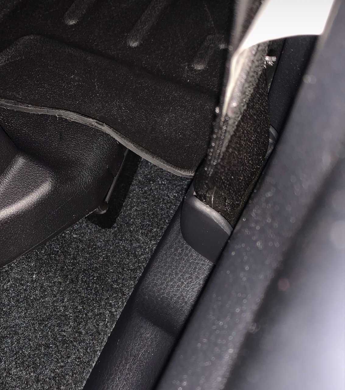

    Any all weather mats that don’t go over the rear plastic piece covering the rear seat bolts? Not having the mats sit flush anymore with weather techs is gonna drive me insane later on

    Trim the mat to clear the trim piece. You won't lose any protection from water.

    tonered likes this.

    @tonered so if I was to test with washers rather than gamble starting with 1” do I need a longer bolt or will stock be just enough? Do you happen to remember the size washer etc? At first I was interested in v2 but after thinking about it v1 seems more solid and the fact you can add extensions whereas v2 is no extensions.
    it also looks like the only rear mats that don’t cover the rear bolt/trim is the OEM weather- I don’t have any desire to cut up a mat to fit so if there are other options that work, I’m all ears

    You will definitely need longer bolts to match the additional spacer length. If you get flanged bolts like the OEM, you don't need washers.
    The V1s and V2s are equally solid, but you are correct about the extension situation.
    I only have the Toyota mats and am happy enough with them, esp since I added snaps to the passenger side.
    If I had other brands, I probably would not mind them being raised up a bit. But, that is all personal preference.
