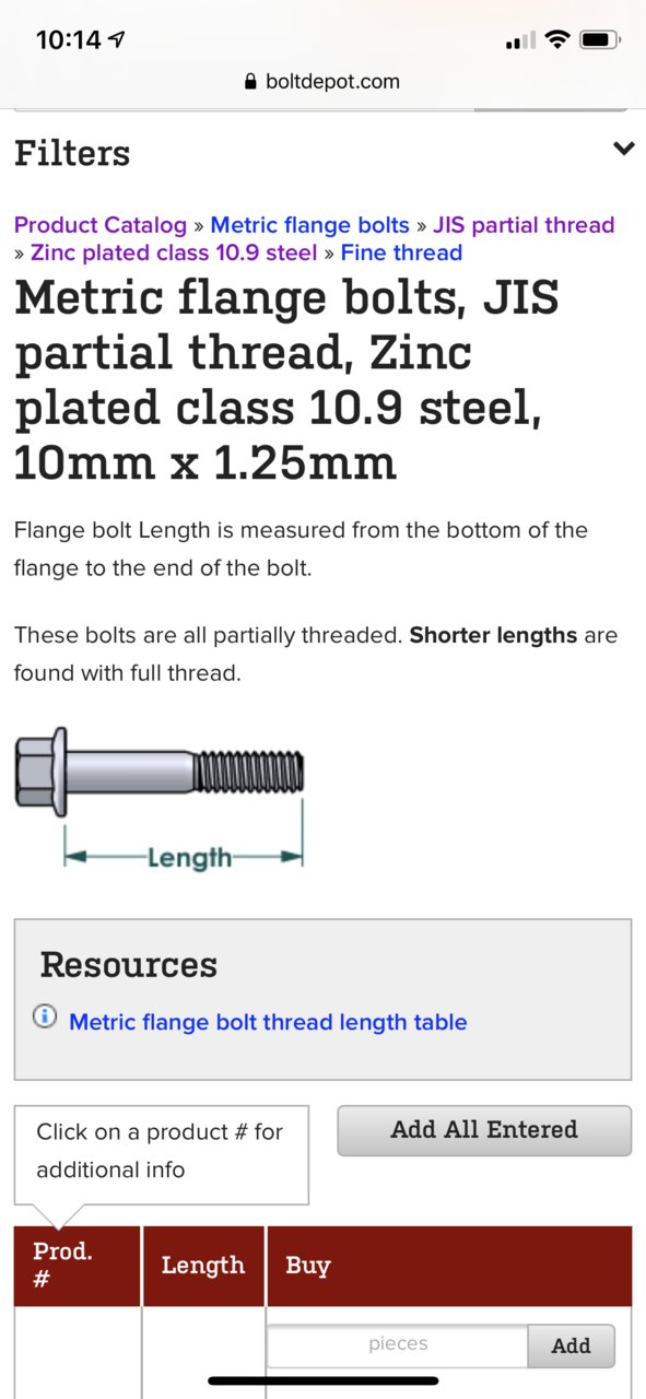

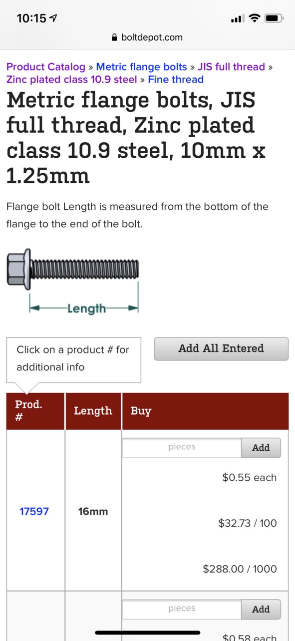

    just to confirm bolt size/type and full or partial thread?
    edit: ok I completely missed the part right above the red bold on post1. So this is the correct bolts but what about full or partial thread?

    You can go with a shanked bolt. You just don't want the shank section to be longer than the spacers.
    Some of the bolts that I have are shanked. Typically you don't want threads in bearing / direct contact with a shear load.

    So after looking at the dimensions on that partial thread- the thread length is 21mm so the body is 29mm of a 50mm bolt. That 29 will roughly be 1 1/8” so that leaves 1/8” bigger than the spacer. You said not bigger than the spacer but is that 1/8” actually going into threads or will the seat mount bracket itself (which I’d guess be at least 1/8”) eat it up?
    I’m guessing “threads in contact w/shear load” your referring to the spacer itself being the shear load. So basically it’s better to have threads only when being used basically

    An 1/8in longer is probably not an issue, but I do know there are better options. Have a look at Ace Hardware. I picked some up there in the past.
    Not the spacer, but just the seat rail portion. Even then, no threads in bearing is more for constant or repetitive loads. The seats will hopefully never see a loads like that. A collision.

    What better options? Can you give example.
    I refuse to shop anywhere that is requiring a mask so ace is out for me. I guess I’m confused by your initial reply because I thought you were saying the partial threads were better or ideal

    A better option would be a bolt with a shorter shank. Myself, I wouldn't order them and find out that the shank is bottoming on the threads when there are shorter shanks readily available. Just my opinion.
    Yes. A shanked bolt is better than full thread in a shear loaded application and generally good design practice. Like I said though, these will only ever be loaded in shear once. On the analytical side, the critical loads are at the floor level. Combined bending, shear, and tension. The OE bolts were only subject to shear and tension without the spacer.
    With spacers, only the seat rail loads the bolt. The spacer is just along for the ride.
