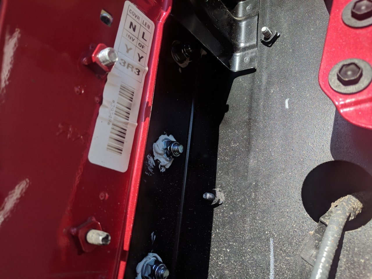

    Also, what @tonered means is that you needs threads in this circled area all the way up to the head ... if you are going to mount something with limited thickness. The thread will likely "bottom out" before it draws anything tight otherwise.

    Yes, that's how I read it as well, thanks for confirming. My plan was to recycle the OEM bolts I'm no longer using or use the ones which came with my rear seat molle panels which I can't use with the risers. Since they are beefy.
    Finding M10 1.25 thread flange nuts is a little tricky it seems. I think this would do it though.

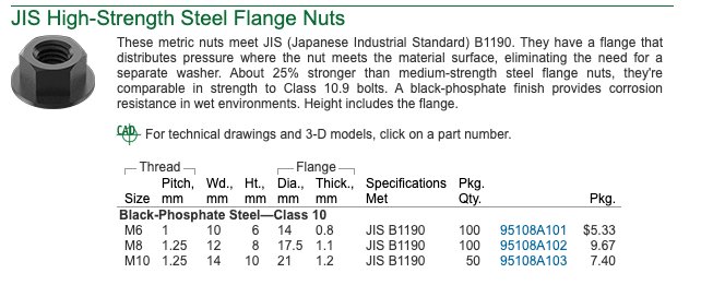

    They don't seem to have a flanged nut online, but I think we could get an idea from these:
    McMaster isn't the cheapest at times, but their delivery times are near Amazon like. I've heard that they have a storefront near me. I need to stop in.
    We also have Fastenal and TacomaScrew. So, finding something is never too hard.

    The only issue with a non serrated nut is loosening over time right? Which is what lock washers are for? For a bed stiffener this aspect is probably more important than usual, particularly because the mini stiffy is a one holer. I think I would prefer larger surface area hence the flange as ideal.
    Hence I’m thinking serrated flange m10 1.25 FTW and stainless a bonus. Price is a little ridiculous at $5 each but I dunno, f it?

    Ahhh! Now your getting into the weeds, where I live at times.
    There is a lot of good info out there on mechanical thread locking. AvE has done some fun testing also. I like the nordlock washers, but have not used them yet. It is a cool design.
    A larger flanged base is a lower clamping pressure. Also, fine thread is stronger than coarse thread. Fun stuff!
    The sereations do help, but for this application, I'd say nylock nut and washer. Plus some sealant on the back side to protect the stanchion.
