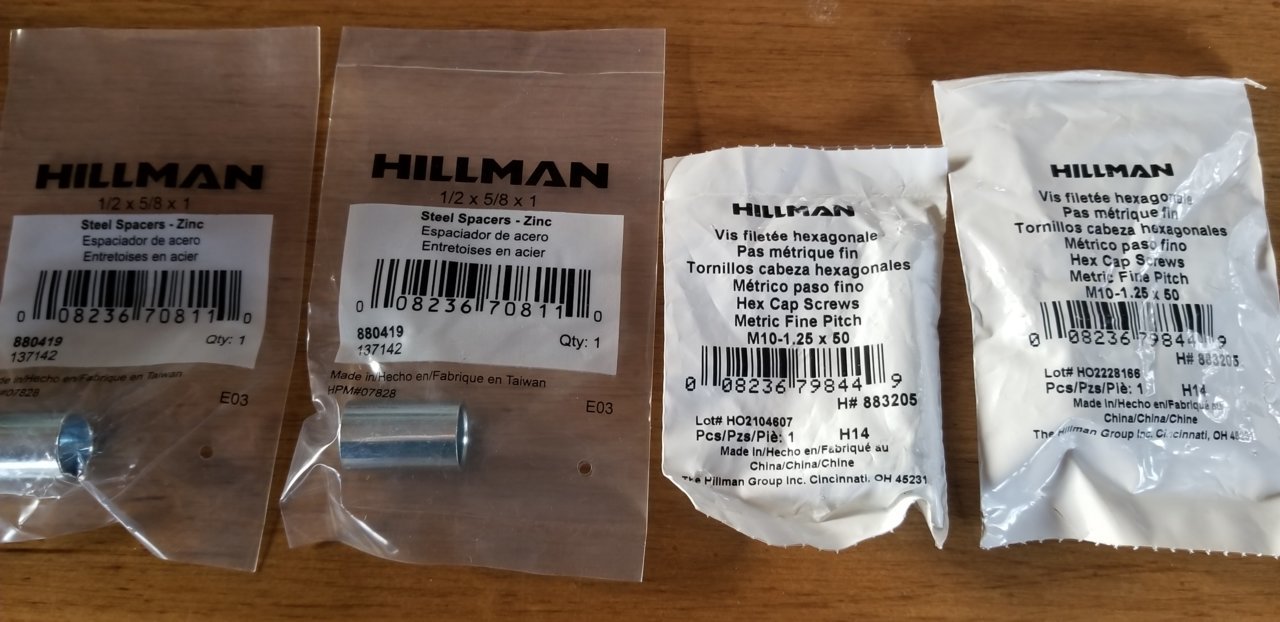

    I know, I know!
    Here are those items. It's only a few dollars to try. Then you can purchase the nice ones from the OP.

    I know it is temporary, but I just wanted to throw out a bit of caution.
    My Lowes didn't have the bolts. Please just be sure they are Grade 10.9. It doesn't say on your packaging. They should be, just concerned.
    Also, my rough calcs looked at the bolt bending due to the spacers as a pure shear and bending load, very similar to what you installed. The extra width of a washer stack or a larger, round or shaped spacer gives a lot of bearing area that makes the safety factor even better. Also, in a rear or side collision, those tube spacers would likely crush and be an injury problem (I have been rear ended several times. I got stories to tell about yielding and nom-yielding parts. Thankfully all minor.).
    Again, I know it is temporary, but I just wanted to let you know.
    Have a good one! :cheers:

    Thanks Tony. The grade is 8.8. They are indeed temporary.

    Cool! Just (another) note, metric Grade 8.8 is less capable than SAE Grade 8. You will want to upgrade those when you get your spacers. O'Reillys had 3 Grade 10.9 bolts for $4 when I did it.
