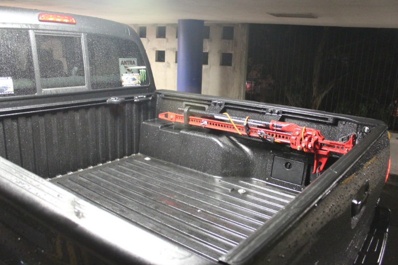

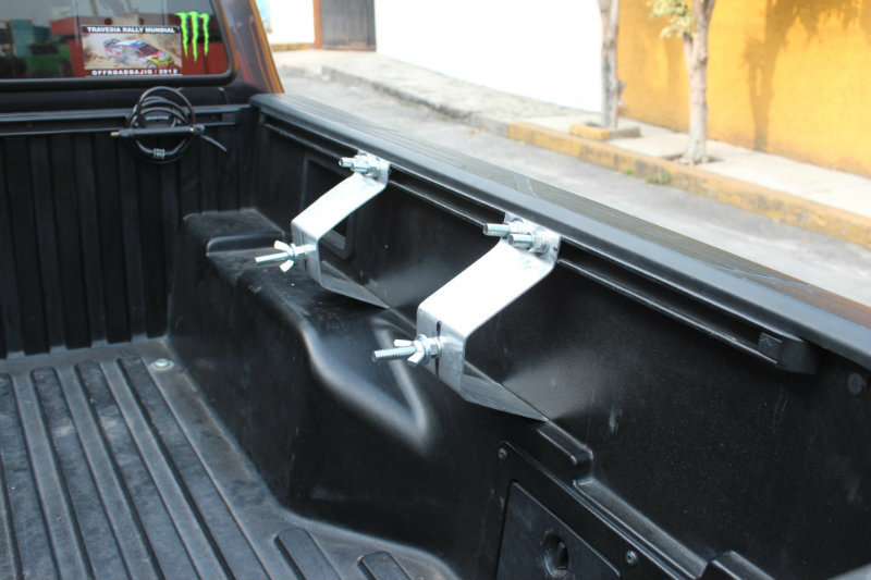

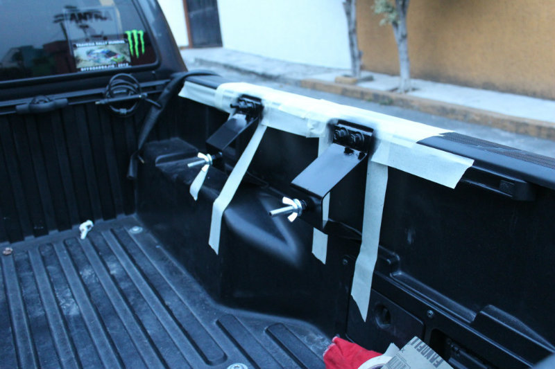

    Hey I did mine... I cut and glued a part of a bike tube (I glued to the Mounts...)
    here I was testing:
    And here you can barely see the tube...
    How it looks with my HiLift
    I actually use the Bungee stripes for the vibrations on the HiLift... the bed is ok, no wear and there are no noises from the mounts bumping...
