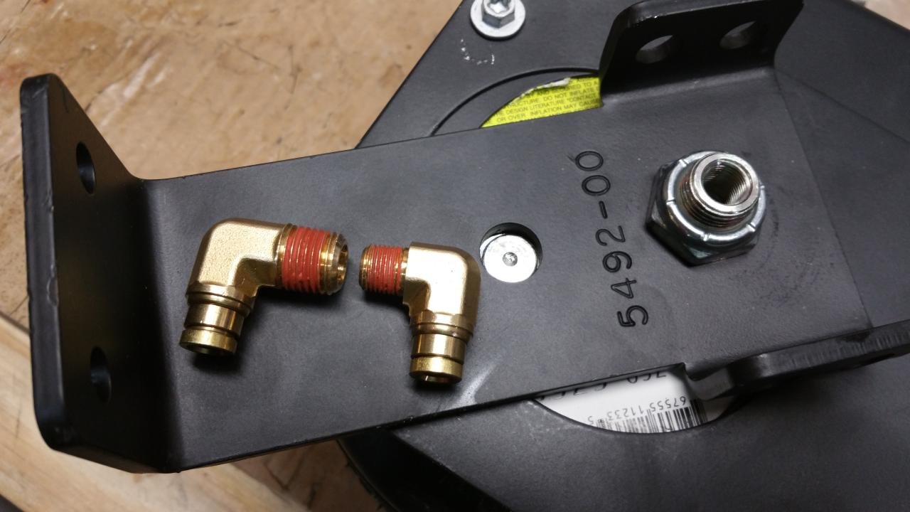

    Its like an epidemic of wrong sized air fittings. WTF is going on with your QC Firestone?
    Went to two HDs to find alternatives for now and will contact FS for replacements. rps20170826_215713_877.jpg

    Yes, the brackets appear 1/2 inch short at the cutout.
    Hadn't seen any write-up or comments on this before so cut some steel bar and bolted it to the brackets to fill in the cutout and fully support the bracket properly on the axle.
    Contacted Firestone tech support, they're mailing out some properly sized air hose connectors.
