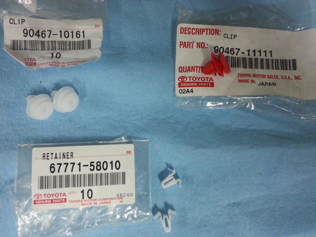

    Here are a couple of tips I would also add in this thread to make things go smoother and save some trips to the parts department.
    Here is an excellent Headliner removal thread 2012+ that I bookmarked - this one has step by step w/ pics and helped me a lot with that part:
    http://www.tacomaworld.com/forum/2n...-dc-interior-head-liner-removal-write-up.html
    Also as a general rule when putting things back together, remove all the retainer clips from the truck door/body and insert them in the trim panels. Particularly the V shaped white retainer clips for the small black trim panels on the top of the doors. Just squeeze that clip together with your fingernails to get them out of the door and pop them into the backside of the panel. If you don't remove these, some will break off into the door when you try to pop the trim back in. Overall putting all the retainer clips in the backside of the panels makes reinstallation much easier. Most of the clips come out still attached to the interior panel but some clips break when you twist the panels around to remove them, some of the heads break when you pull the panel out and some just stick to the body but can be popped out with a putty knife and reinstalled on the backside of the trim piece.
    The two red clips for the top of the B-pillar trim panels in a DC were the worst for me on re-install. It has a tab on it and has to be twisted to the right position to receive the top trim panel. I tried removing those red clips intact and never could. So when I dropped my headliner, I had replacement clips on hand and just cut the originals off with a putty knife and rubber mallet, saved me 30 mins of twisting the B-pillar top trim to get them back in.
    I would also have about 10 of the 10161's on-hand for reinstalling everything on a DC. The Red retainers are the 11111's and if you don't take the V shaped clips off the door, you will need some 58010's (and comparing the price with the others, Toyota is most proud of these). Here are the clips and part numbers:

    Extra parts are very, very important. Fortunately for me, there is a Toyota stealership a few block away (I made 2x 5 min walks of shame) to the parts dept. Bought extra panel clips (the white cone/Christmas tree ones 90467-10161) and ended up replacing about 10 or so. There are a few other types of these clips, and managed not to lose or break any. A few of the white panel clips had to be drilled out (just like a rivet) on the pillars where you can't get to the back to free them.
