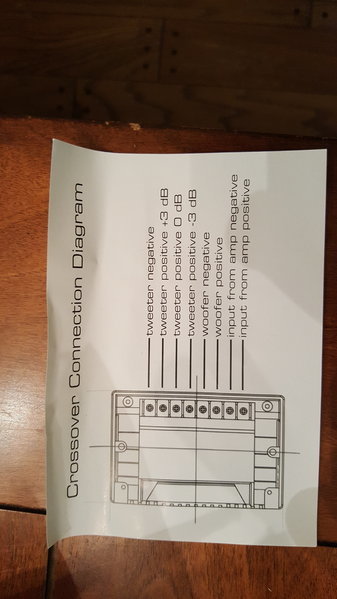

    I have 2 hybrid audio crossovers that i ended up not using in my build. I think ebay has them for 75-100 each, i will sell you both for 120. Let me know and i can post some pictures for you.
    Here is a pic of the crossover diagram...
