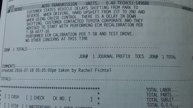

    The T-SB 0077 16 made my truck shift property and it has 0 delay when going from reverse to drive also all but Eliminated the cruse control gear hunting this is how they should have worked to start with i drive alot with my job maybe 150 miles a day so this updated software has made me love this truck even more
