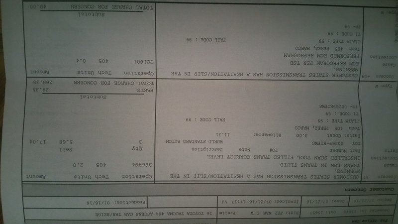

    Picked mine up and did an extended test drive.
    Jumped on freeway put it on cruise control at 65mph and went up the grapevine(very long grade here in LA) way better stayed in one gear all way up at around 3k rpm. Before it would jump around and wind out the motor to like 4-5k rpm.
    Twisty hilly road test. Seems to stay in gears a little longer, smoother shifts.
    Seems like a new truck to me, I am very pleased. They also added fluid to the tranny. I can't really tell from the receipt but it looks like they put in 3 quarts!!!
    http://imgur.com/a/1h1jY

    3 friggin' quarts... Get The F outta here... That's is hard to believe man.... You might be able to get an extended warranty on the trans...??

    I wonder if they just used your job to "true up" inventory. They may have used 2 quarts earlier in the week and figured they throw yours and the others on the warranty invoice to so the overall amount used stayed correct. Or they pulled 3 quarts from stock and added it to the invoice, used 1.5 and the rest is waiting for the next job or the tech's personal ride. Just speculating.

    3 quarts is a LOT to be low. Holy shit balls batman. That could leave some longterm damage to the internals. I'd be raising hell with corporate. No excuses

    Agreed, I am going to open a Corp ticket tomorrow. It drives like a whole new truck after the TSB and fluid topoff, but who knows how much life having it that low sucked out of it.
