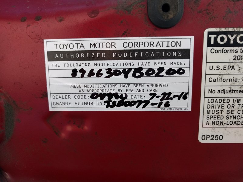

    i know it's been linked, but here's a picture of the underhood sticker for quick reference.
    The hammer and damnfingers like this.
