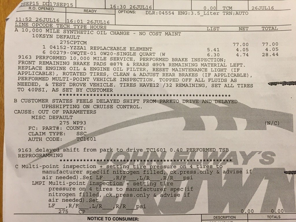

    Figured I would post in this thread as well.
    Had my 10k service along with the TSB reprogramming performed. It's classified on my paperwork as TC1601 which is the OP Code for TSB-0077-16. I can definitely feel a much better throttle response off the line and holding the gear much better before shifting. Delay from reverse/neutral to drive is completely gone so far. I'll report back in a few days, but so far so good.

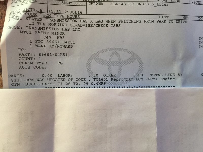

    So just got the TSB done (no sticker installed). This is the work sheet. From reading this I don't see any TSB number or the new patch code. After saying that I drove it about 20 miles on the highway. Shifting seems smoother as well as speeding up to pass people going 75mph.
    My worry is that it's in my head because of hardly no info on the work order about the new update.
    Am I just being paranoid?

    Probably...
