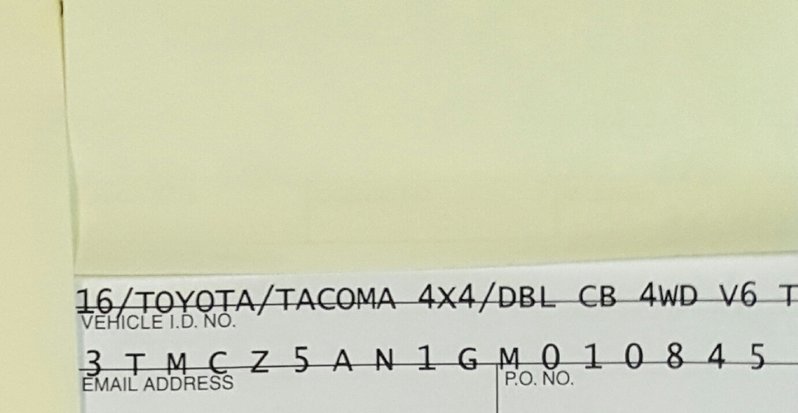

    Wait so it is related to VIN? Is there a date range too?

    It is definitely related to your VIN...i just want to know if there is anyone with the v6 and auto whose vin is not listed, but i think they all are. I don't see a date range, but it looks like all 2016s were affected with v6, auto.
    If you look at stickied thread, the op's post with the pdf, on the first page it says under applicability...Years, models, and additional information. It has all the VDS(s) - vehicle identification numbers listed.

    EZ5CN IS LISTED. So your truck is listed.

    Working from.phone is mine affected?

    Yes CZ5AN is on the list. Bring your truck in.

    Yes, it's on there

    All good, starts with the 4th digit, and is 5 digits long, so just go into your dealer and print the tsb or write the tsb number down.

    That would be correct. No vin listed, you are ok. If you see your vin bring it in.
    The listed vins starting with 4th digit (from left to right) include: AZ5CN, BZ5DN, CZ5AN, DZ5BN, EZ5CN, GZ5AN, RZ5CN, and SZ5AN.
    Engine: 2gr (v6) Transmissons: 6AT
