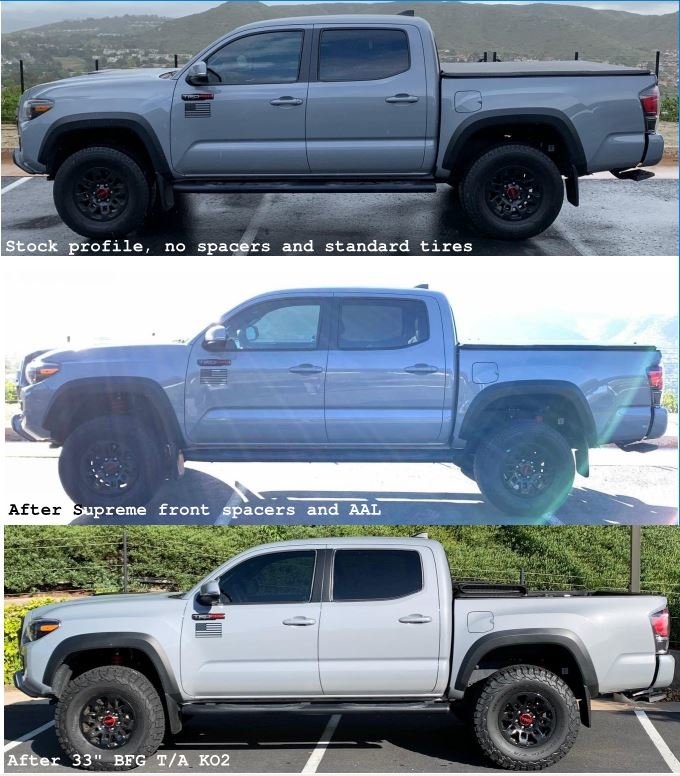

    No cutting needed for the 33" tires, from what I've read is that even with no lift on the pro you can fit 33's but I can't say for certain. The ride feels exactly the same, not stiffer nor bouncier. The gas is DEFINITELY noticeable, and I might look into re-gearing... but that is all a result of the tires and not the lift. When I did the lift first there was no difference in MPG or hunting for gears.

    @Brent_Blacke 100% in agreement with what @BlueFourMike just said.
    I too have 285/75/16 KO2's with no issues of rubbing, no cutting, and stock UCA...

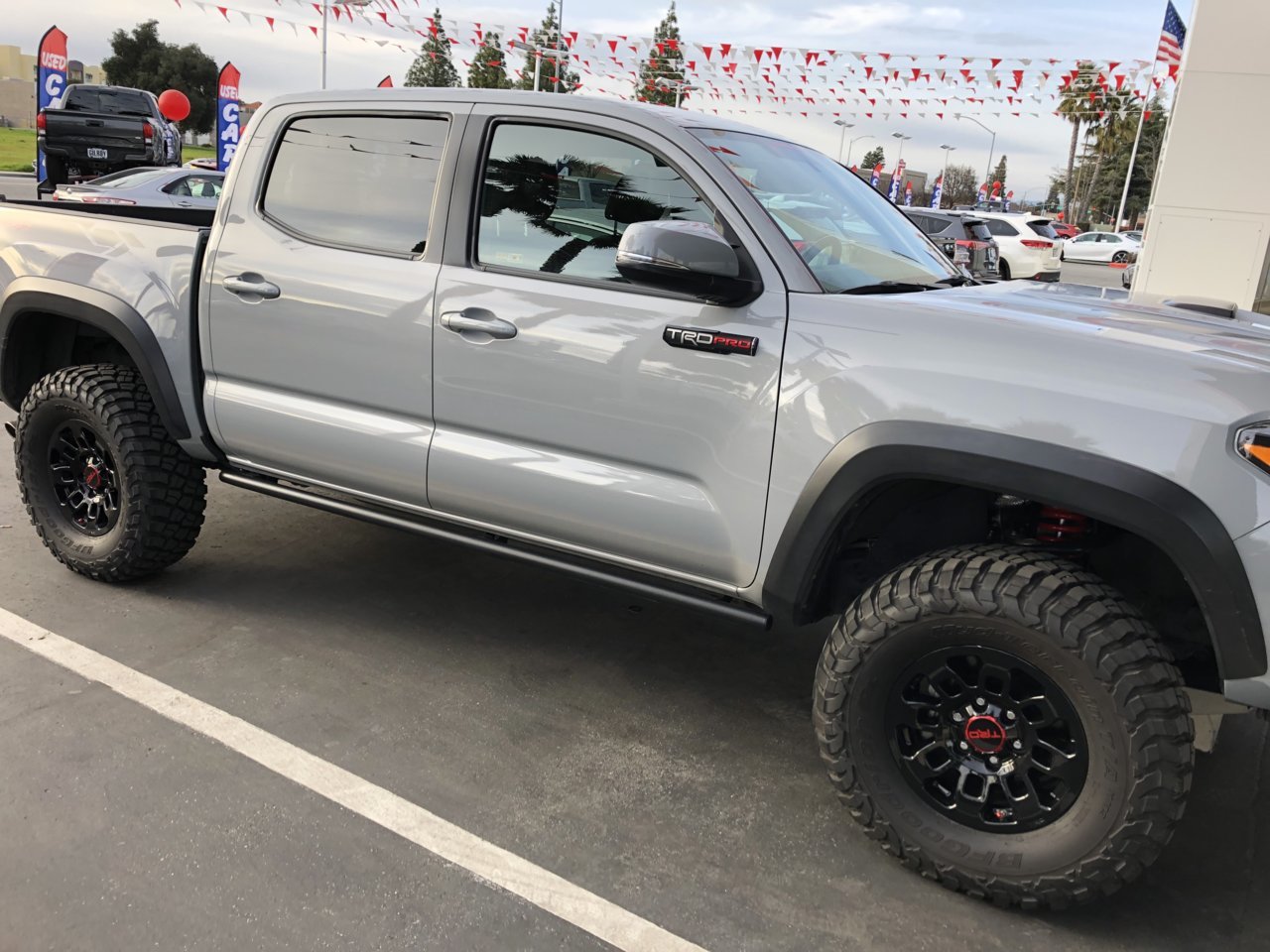

  11. Aug 23, 2019 at 4:23 PM
    #71
    BlueFourMike
    BlueFourMike What does this button do?
    Oct 2, 2018
    #268185
    308
    Vlad
    North Carolina
    2018. Black. Tacoma. Professional.
    Many.
    Yep. TRD Pro wheels and KO2s.
    This photo is a few months old. I had the Revtek leveling kit installed yesterday. Very happy with it.

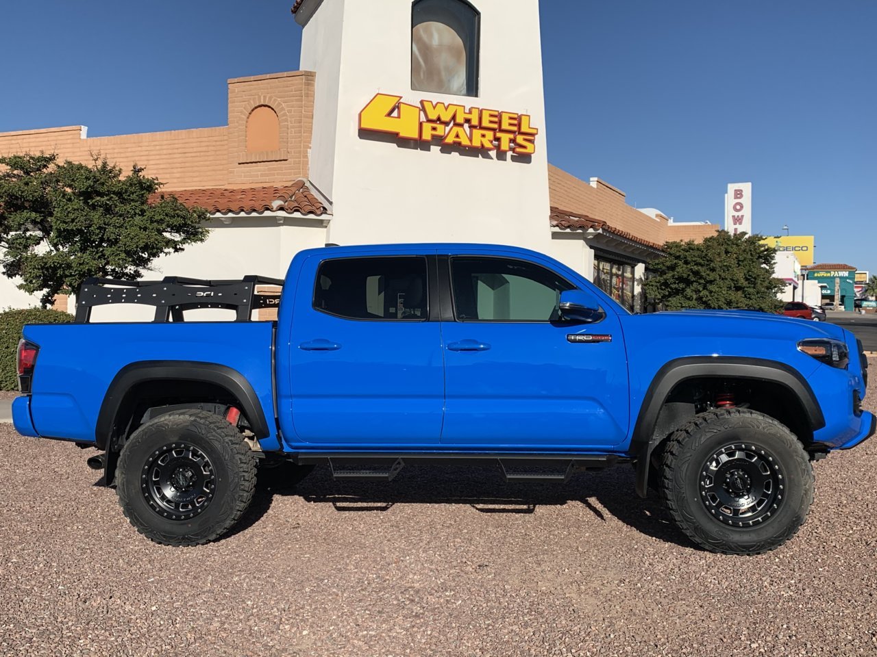

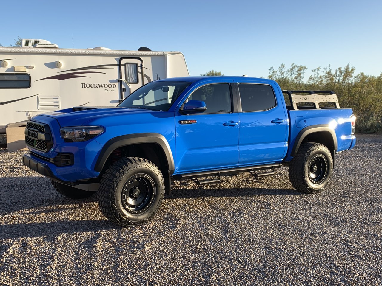

    Voodoo11
    Voodoo11 Member
    Oct 17, 2019
    #308280
    8
    2019 Voodoo Blue Pro
    5E46D183-0A2D-4DDD-9EAE-37DF5410AF80.jpg 310BC198-7F97-46F2-9449-EE453ABEF1C8.jpg
    I’m running the Nitro Procomp 65205K 3/1 kit. 4wheelparts did the lift for the dealership prior to purchase. Their site says the kit is not compatible with the pro but are claiming their website is incorrect and installed it for the dealership. I worked the lift into my deal so drove the truck pre-lift stock. After upgrading the wheels and tires with the installed lift I had a nasty Cali lean and a terrible ride. Today I removed the 1 inch block in the rear end and went to a 2 inch block and it looks much better. The diff spacers were installed as well. Overall happy with the trucks stance and ride quality once I got the rear end picked back up and did an alignment.
    Tires: 285/70/17 Procomp MT2’s
    Wheels: Procomp Hammer 60’s
    71tattooguy likes this.

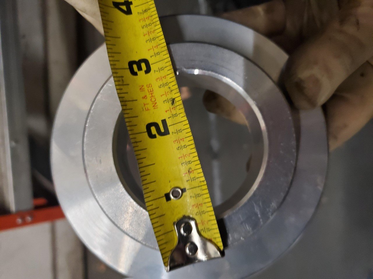

  15. Nov 19, 2019 at 6:03 PM
    #75
    kilshaw
    kilshaw Member
    Nov 19, 2019
    #311187
    5
    Ben
    2017 Tacoma TRD Pro
    Something is not right...

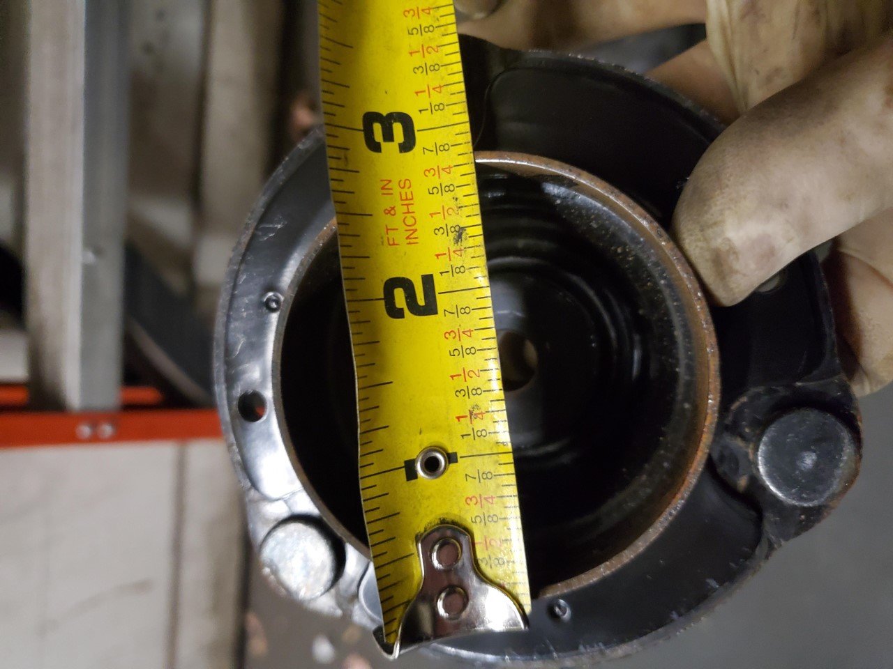

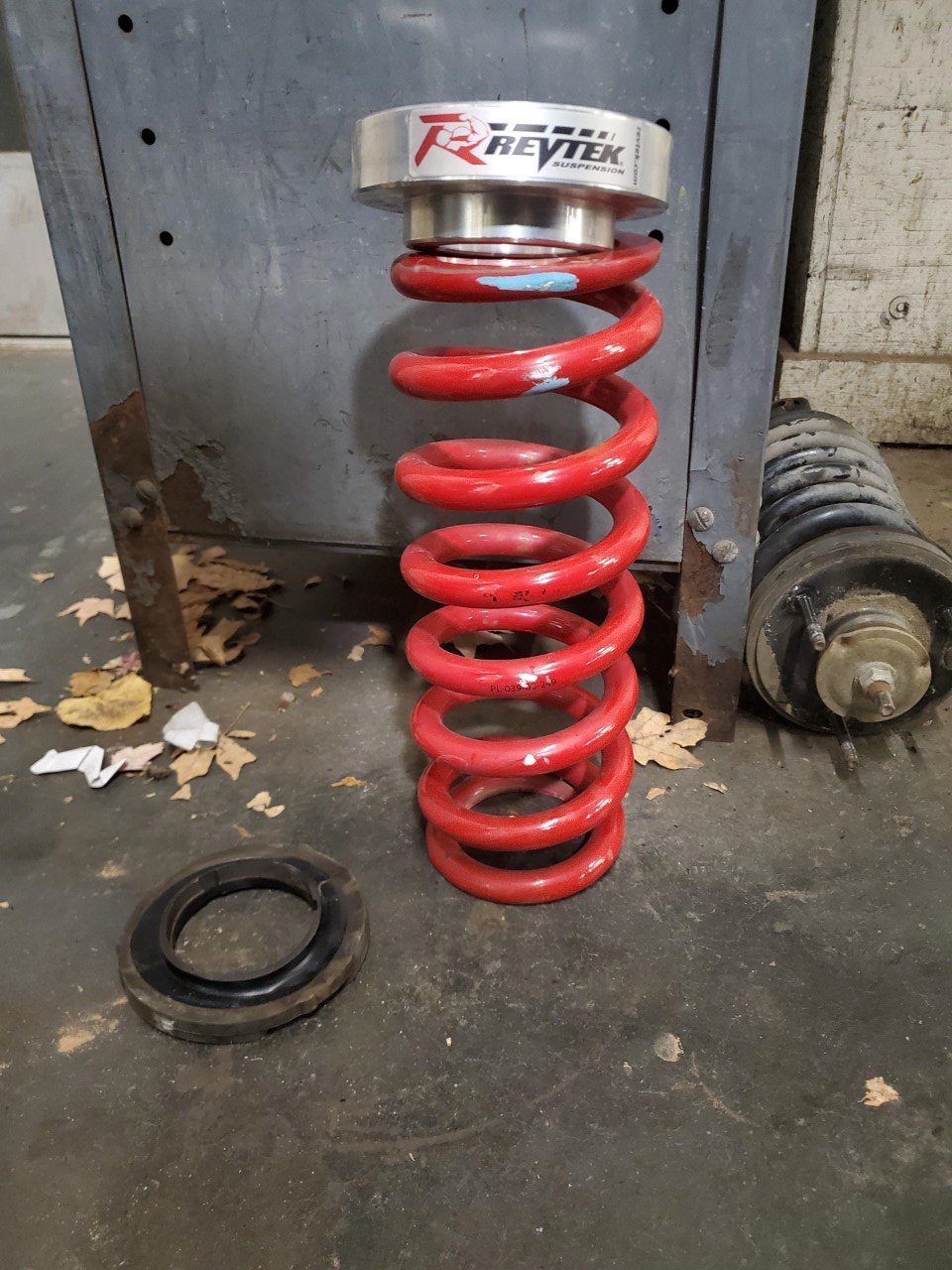

  16. Nov 19, 2019 at 7:11 PM
    #76
    perkj
    perkj Well-Known Member
    Aug 31, 2016
    #196051
    972
    what is the revtek item number you received?
  17. Nov 19, 2019 at 7:20 PM
    #77
    kilshaw
    kilshaw Member
    Nov 19, 2019
    #311187
    5
    Ben
    2017 Tacoma TRD Pro
    Kit 427AP. Double checked and this should have been the right kit. I suppose the wrong spacer got packaged up by mistake. Grrrrr!

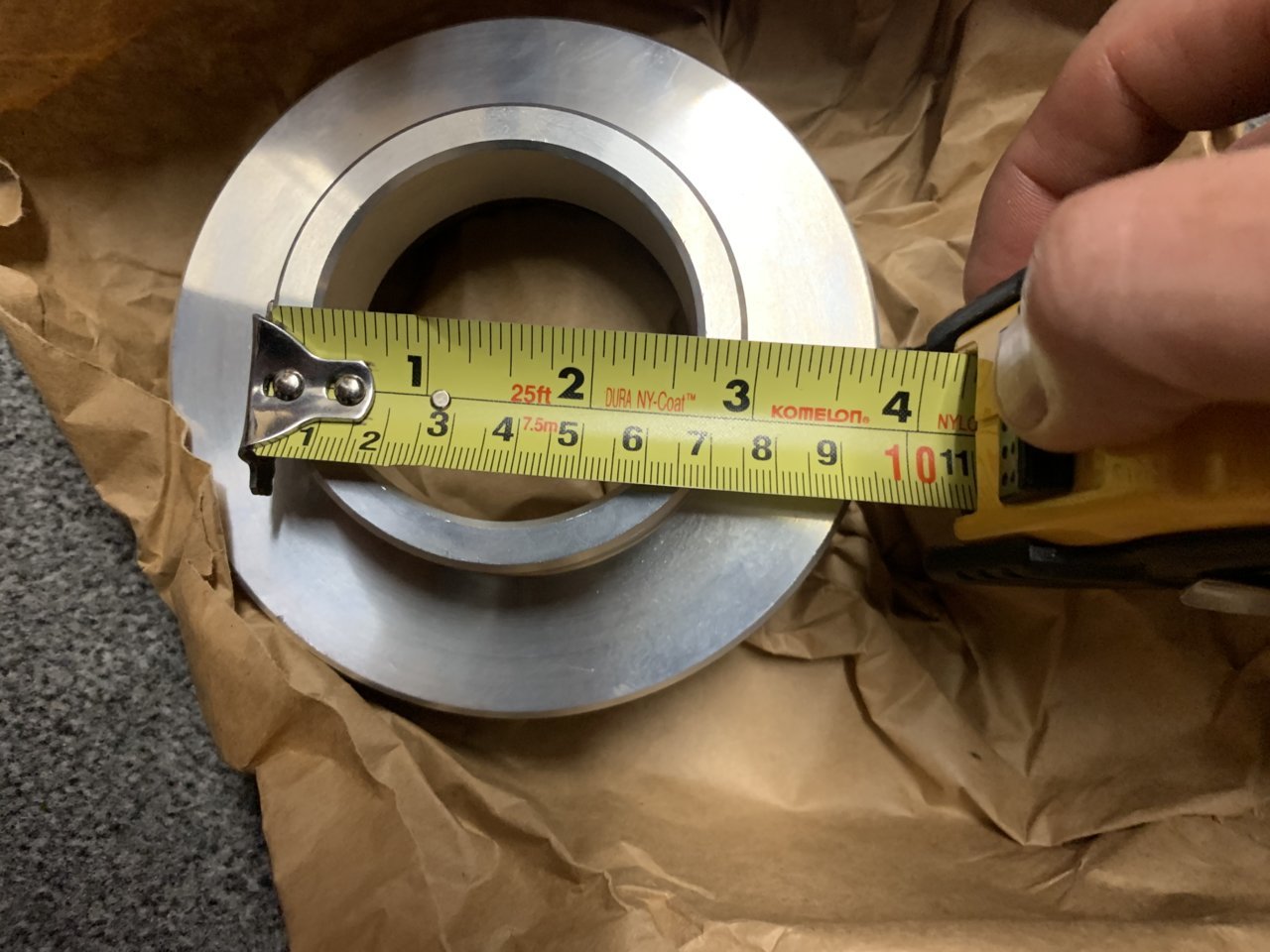

  18. Nov 19, 2019 at 7:33 PM
    #78
    perkj
    Aug 31, 2016
    #196051
    972
    looks to be the case. Here are mine:
    kilshaw[QUOTED] likes this.
  19. Nov 19, 2019 at 7:45 PM
    #79
    kilshaw
    kilshaw Member
    Nov 19, 2019
    #311187
    5
    Ben
    2017 Tacoma TRD Pro
    Whelp, time to call Revtek. Thanks for confirming. I was worried Fox was sending Toyota coil overs with variations in spec., or different year models were using different parts.
    perkj likes this.
