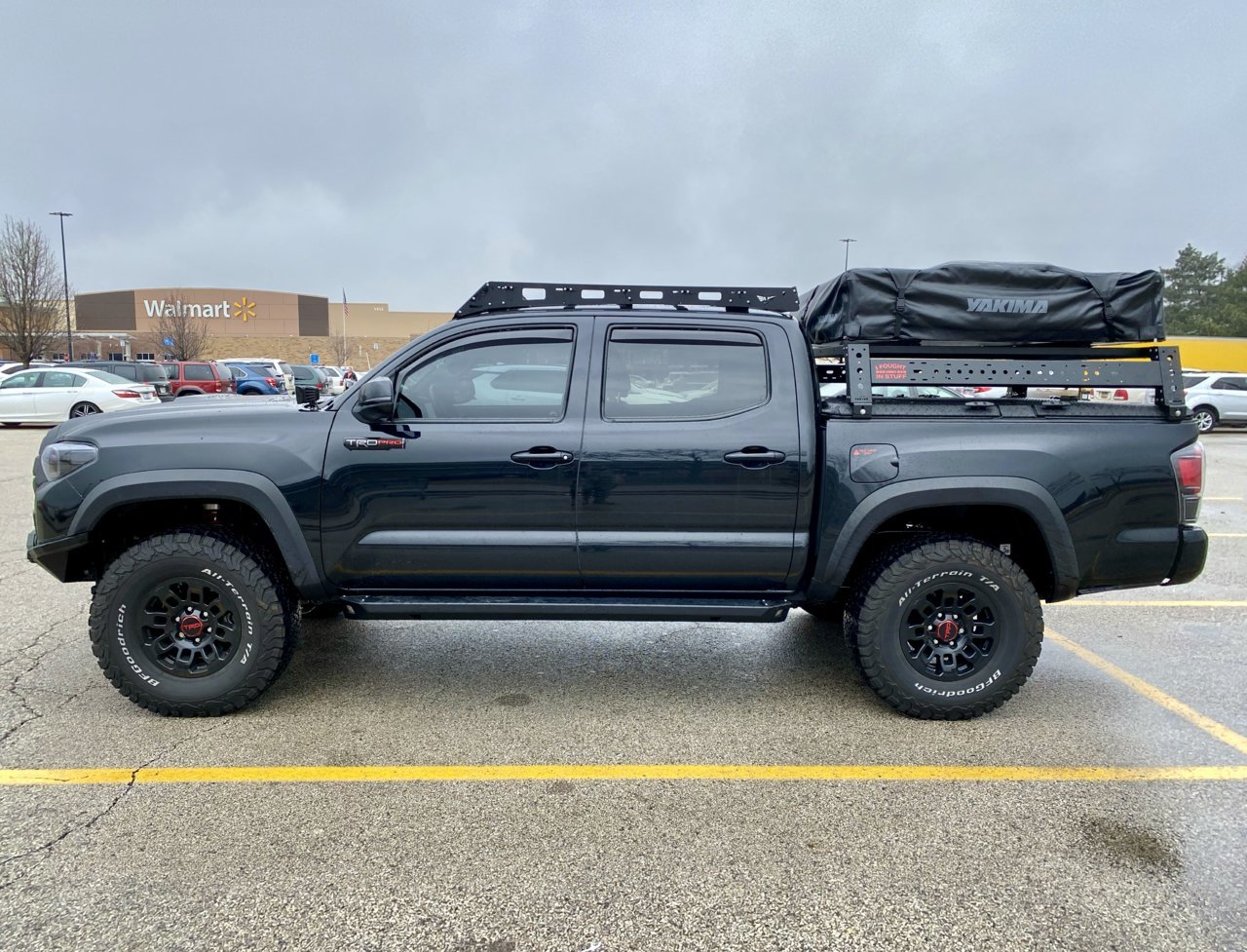

    Can I see a side shot of your truck
  19. Mar 16, 2020 at 10:50 AM
    #99
    BlueFourMike
    BlueFourMike What does this button do?
    Oct 2, 2018
    #268185
    308
    Vlad
    North Carolina
    2018. Black. Tacoma. Professional.
    Many.
    Yes. I’ll take one when I go out.
