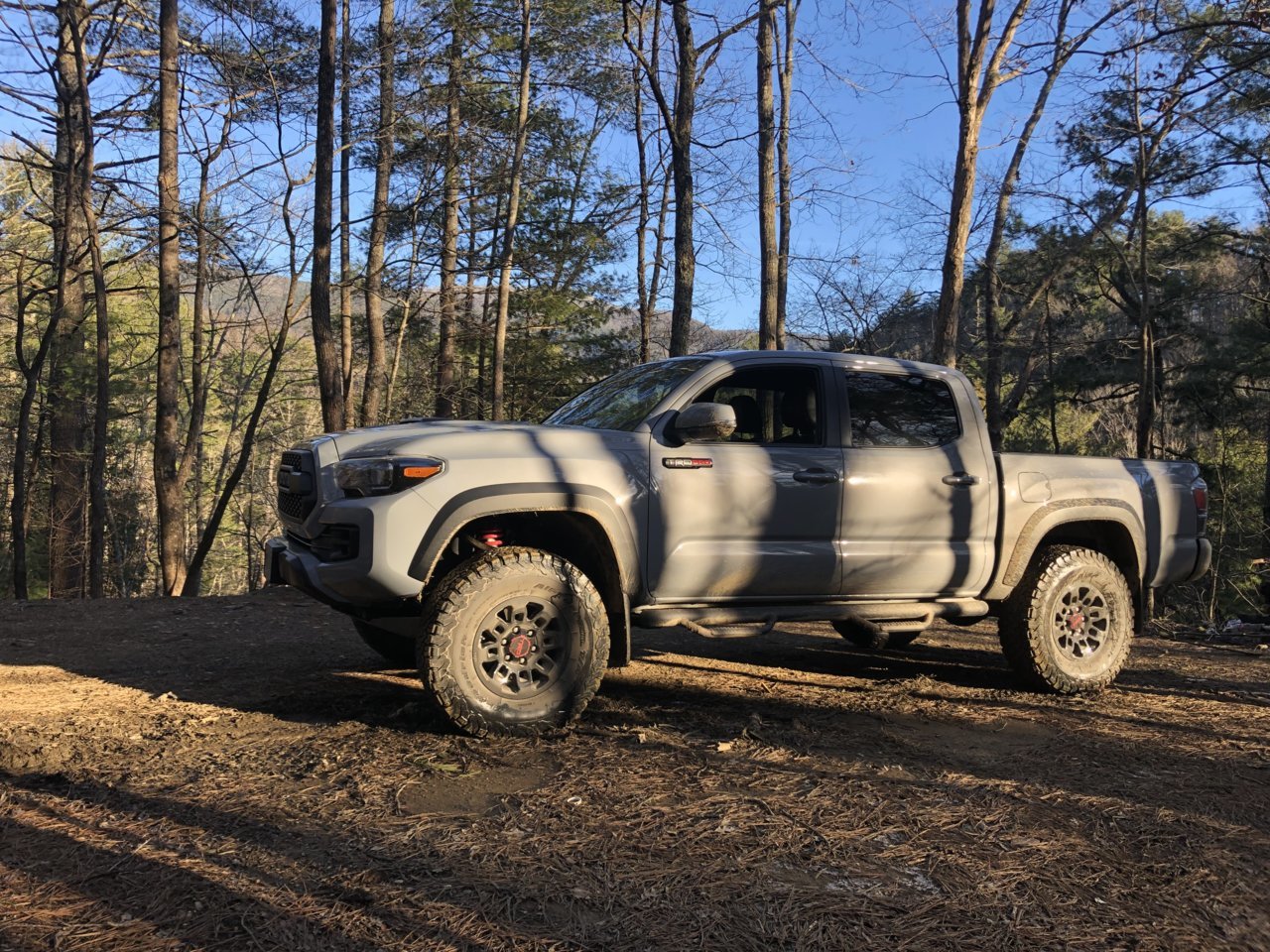

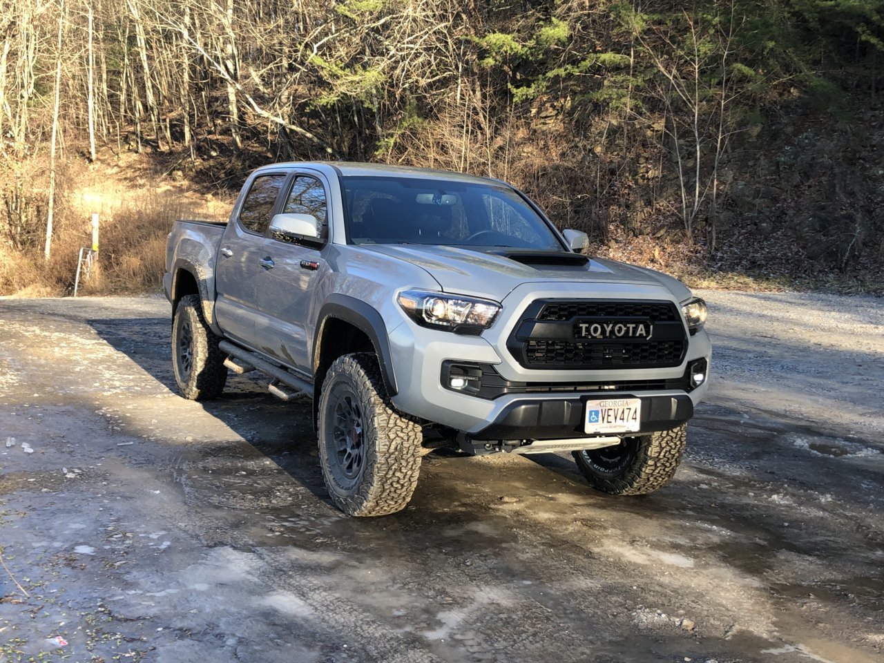

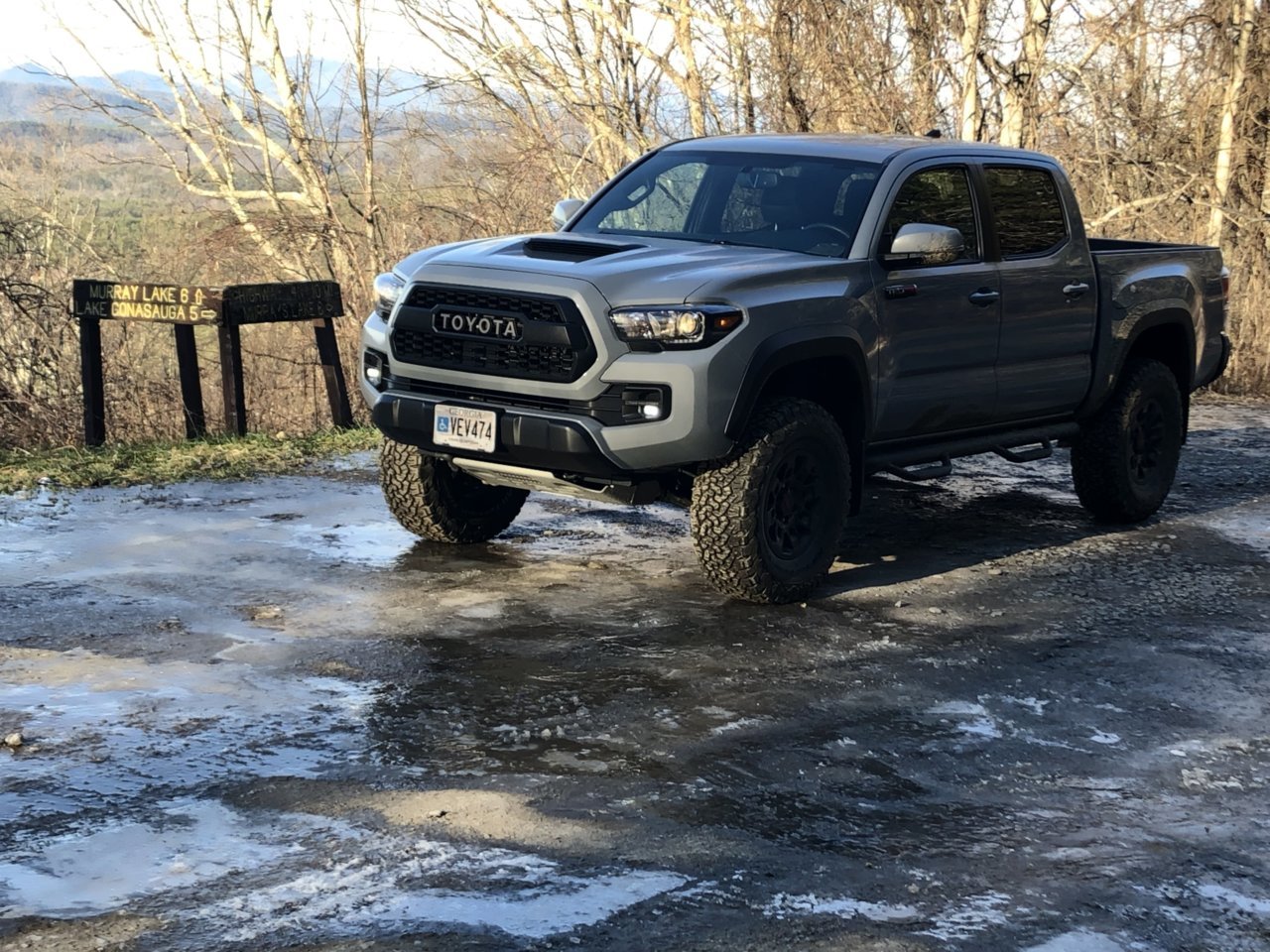

    NICE! I just got a 17 cement trd pro as well. How is the lift kit and tires treating you so far? I’m thinking of doing the same thing.

    Is this the Revtek 1.5"?
