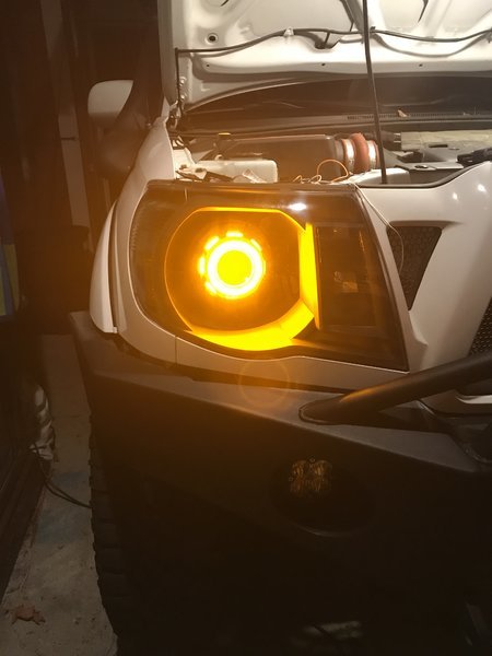

    I just installed new retrofits and plan to use the halos as DTRLS and Blinkers; however, current the blinkers hyperflash unless the old bulbs are plugged in. The problem is, I don't want the bulbs hanging around lighting up my engine bay and I don't want them in my headlights.
    Is there a crafty way to delete or black out the bulb so it's plugged in, but not visible?

    you need a load resistor for LED blinkers

    Just install the grey plastic jumper block on the back of the fuseblock. The part number is 82671-30360. It's about $8 from the dealer. Then you can use the Diode Dynamics SmartTap CF18 Flasher. No more DTRL. No more hyperflash, and a cool flasher that does other cool stuff. The coolest thing is the nighttime illumination while you're walking to your house.
    \https://www.diodedynamics.com/store...arttap-cf18-lm449-flasher-relay/category/789/

    Load resistor. Or you can just tape the oem bulbs with electrical tape

    Picked up a resistor yesterday but haven't wired it yet. Will see if that works. Won't electric tape just melt? That MFer already burned me once. Look - i'm not opposed to just spray painting the bulbs black...
