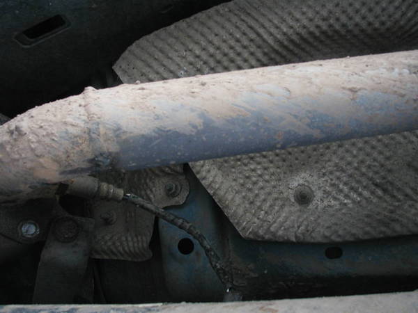

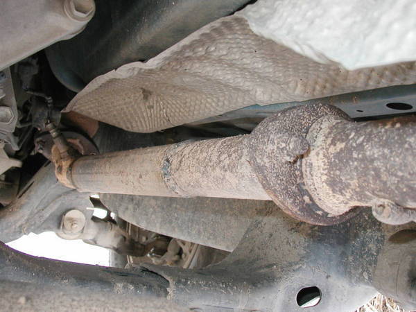

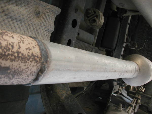

    Here is some pictures of my setup. Given everything is a dirty and I don't have a lift to take great photos, you can see what I did anyway.
    New tip... Generally very shiny, not at the current time though...
    New muffler, and a little extra pipe to fill the gap.
    One cat gone...
    And so is number 2.
    As a side note, I found pieces of front cat screen in my rear cats which tells me that the front ones are on the fast track to shitting the bed as well.
