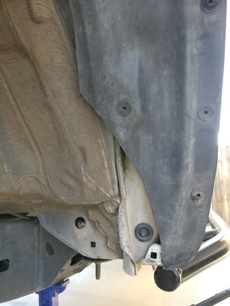

    What did you do to prep it? Sand and primer then bedliner? I'm going to go this route with my flares.

    I just cleaned them and bedlined them.

    Nice. Sounds easy enough, just looked at your fender flare pics and they look great as well!

    I wiped them down real well with wax and grease remover and then one of tac cloths and bedlined. no primer

    i have my plastic cut exactly like yours and im getting some weird wind noise down there on the highway

    Interesting, Ill be driving on the highway tomorrow and Ill report back if i get some wind noise.

    Drove up to about 75mph and I'm not getting any wind noise.

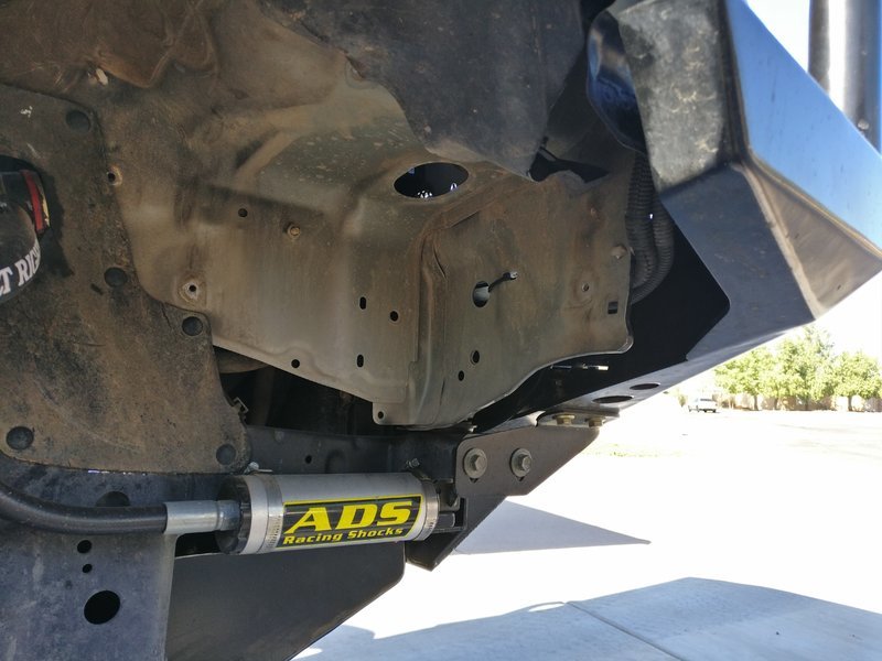

    How did you mount the reservoirs?

    Right to the frame, come with self tapping screws.

    Okay, makes sense now.
