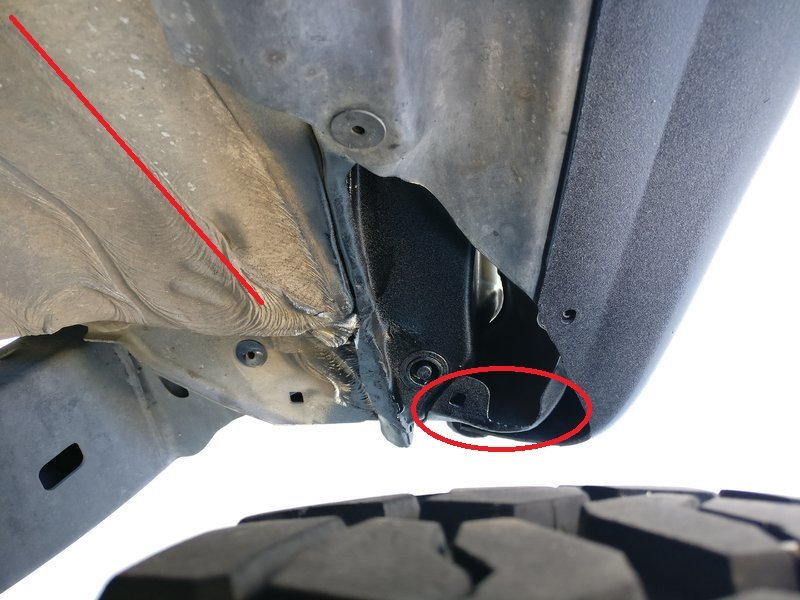

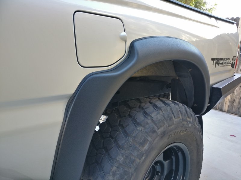

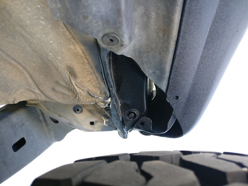

    Finished my trimming, had to hit the pinch weld a lot more and had to cut into the flares. But no more tire rub lock to lock stuffed and unstuffed. Great to know I won't rub anymore, sounded terrible when it did. Also finished theast fender flare...

    At least you haven't cut any sheet metal yet :anonymous:

    Hah, did you? I noticed you cut off the mud flap tab and the pinch weld but other than that

    Yea, I had to cut some sheet metal. Really wasn't that much, but it was just unavoidable since my tires are so wide. I'll be cutting more when I move over to 35s.

    Relocation plates cured all my issues in the rear. What are you rubbing on the front? I dont think im even close to hitting anything up front, but then again you have much larger tires than me.

    I edited your pic because I haven't taken of my since this weekend. I think I will have to remove all of where the circle is. Might have to even just get rid of the bottom of the flare. The straight line I touch a little all throughout the middle. At least my tires clean the mud off that area.

    Ahh okay, where you have circled I rubbed slightly and was able to massage it back with a hammer to clear it. Where your line is my tires clears, but is very very close.
