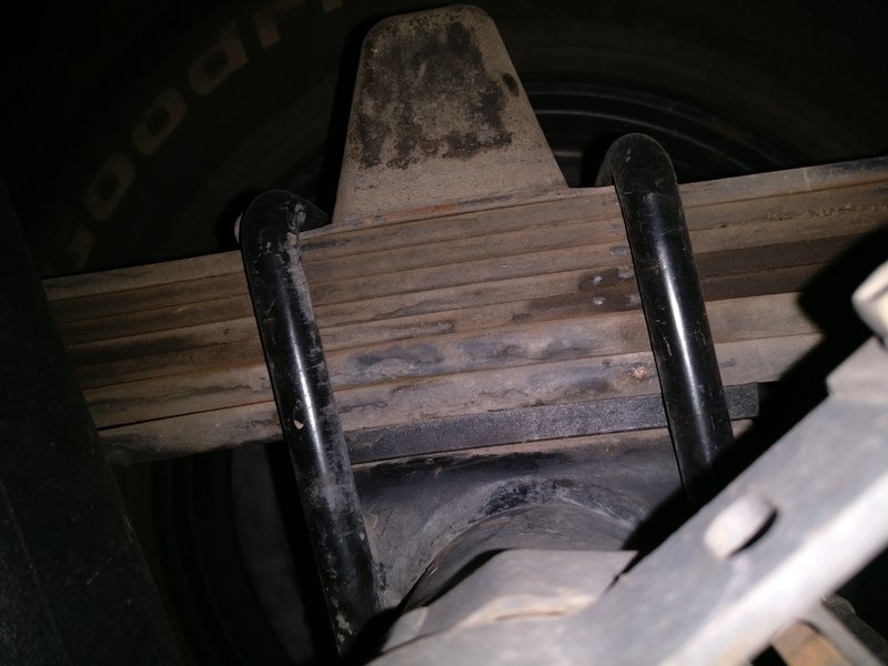

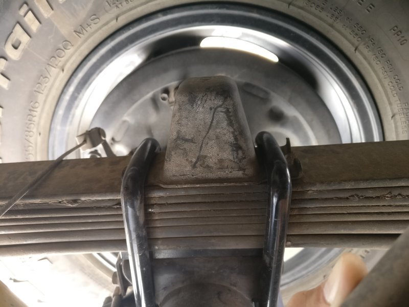

    Check Build
    Yep, 3/4 inch!
    synergy10 and stumbles[QUOTED] like this.

    I knew @Delta00 would come through with the pics. I never have time to stop and take pics of my work when installing parts. Always on a tight schedule.

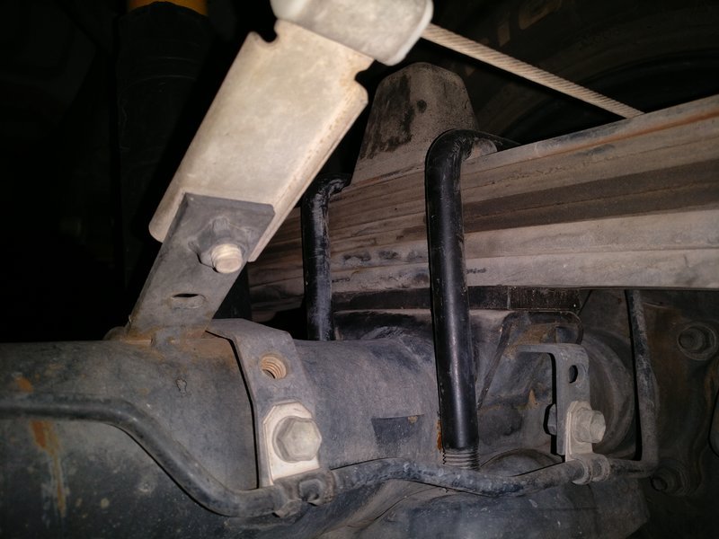

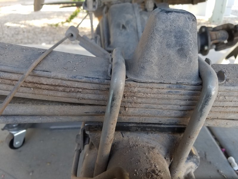

    I had to come back and look at the pics again. I am in the middle of it and just did the first side. Then when I went to put the u bolts back in, I was like this is not fun. My angle seems more and I used the 3/4 side. Maybe it is time to do a u bolt flip and shock relocation, lol.

    #48500
    81,598
    Monte
    Wyoming/St. Louis
    The Trifecta of Taco's
    Angle? What angle? There shouldn't be any angle.

  10. Nov 13, 2016 at 12:57 PM
    #2450
    Blackdawg
    Blackdawg Dr. Frankenstein
    Dec 31, 2010
    #48500
    81,598
    Monte
    Wyoming/St. Louis
    Okay. That's bad.
    The problem is the bump stop as it centers on the cent pin of the axle. Which you just moved. You need to notch the bump stop to allow it to line up where it should
    stumbles[QUOTED] likes this.

    Ok. Thanks. I'll just measure out the same 3/4 inch and it should be the same.

    Yes, I'm pretty sure I drilled some new holes for the center pin the sit in. I still probably needed to move it a bit forward as the u bolts are still pretty far on one side of the bump and close on the other. But I think it works for now.
