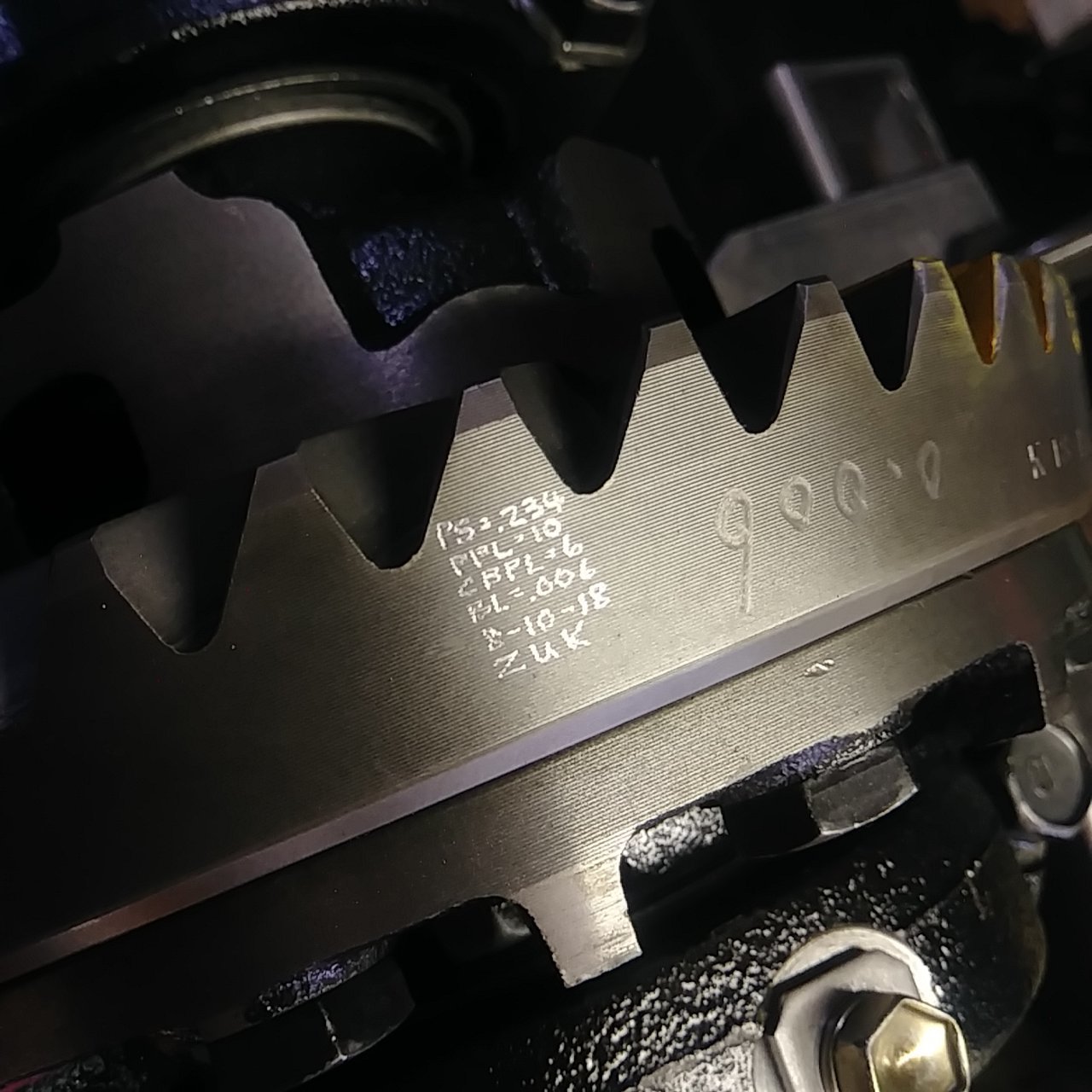

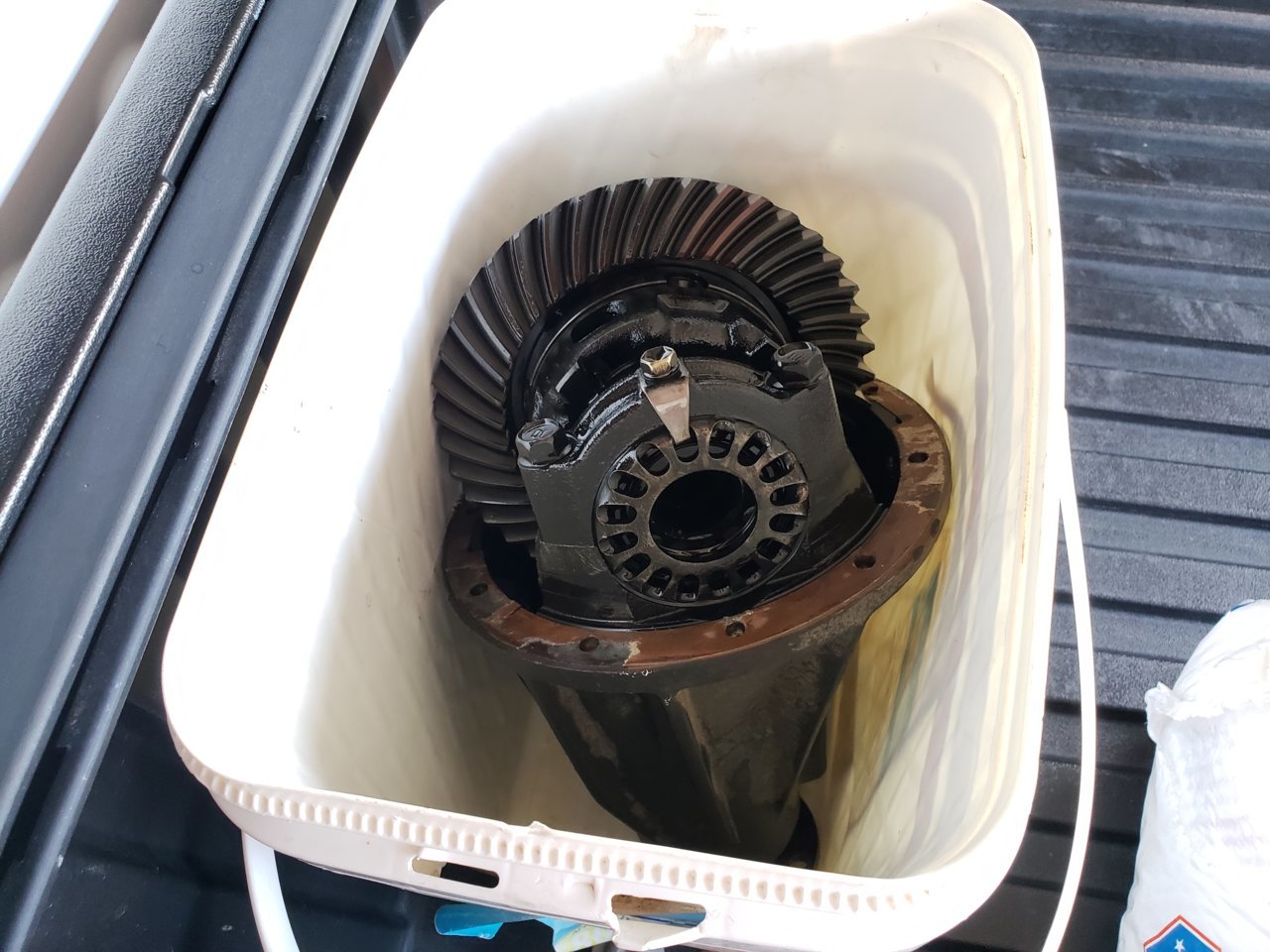

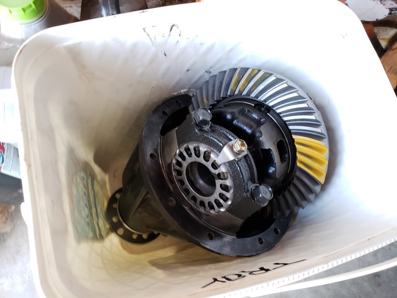

    4.56 ready to go in. Won't be able to install until Wednesday... Need to still get a gasket for it also.

    ZUK lives about a mile from be so just dropped off my diff on Thursday morning and picked it up today at 4! A little sad I couldn't get around to installing it today because I really want to see what difference it makes haha
