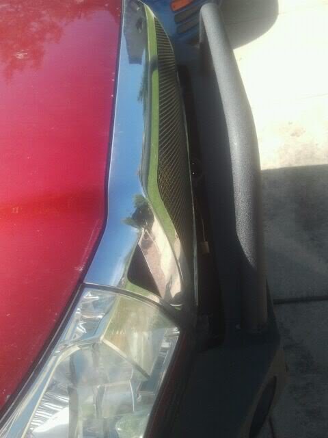

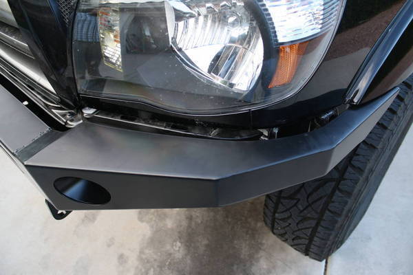

    Can you post a pic of your bumper on your truck from a front/top kinda angled view. I have a large gap in between my grille and bumper and I dont think it looks right. Just checkn to see if yours is the same way

    there's a gap there

    Yep, mine has a gap as well.

    my gap seems excessive for some reason!

    I think the 2011 might be different then the ones he fiited the bumper to. My gap looks larger then the rest. There are four bolts that came witht he kit that I didnt use because my bolts are connected to the frame, not removable and replaceable with the bolts provided.

    Interesting, mine is '10 and I used all the bolts that were given to me with the bumper. I have about the same amount of gap you do.

    I HAVE THE SAME GAP. I THINK THE GAP IS FOR ANY ACCIDENTAL HIT. THIS WAY THE BUMPER DOESNT CRUSH THE LIGHTS OR THAT THIN METAL FRAME THAT HOLDS THE HEADLIGHTS. THAT JUST MY OPINION. I JUST GET USE TO IT. WAITING TO GET A WINCH SOON.

    The gap is because we noticed that the frame and body on the Tacoma have an extreme amount of flex from each other. We built a few that were closer and they rubbed when you take them off road. We could lesson the gap on the next batch but I'm a little concerned it will rub offroad.

    Love the bumper and don't mind the space at all, just wanted to make sure I put it on right. Thanks guys!

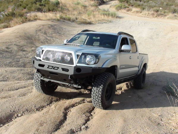

    Here it is....

    ^^ Boom, there you go. Gap is needed. DeMello rules.
