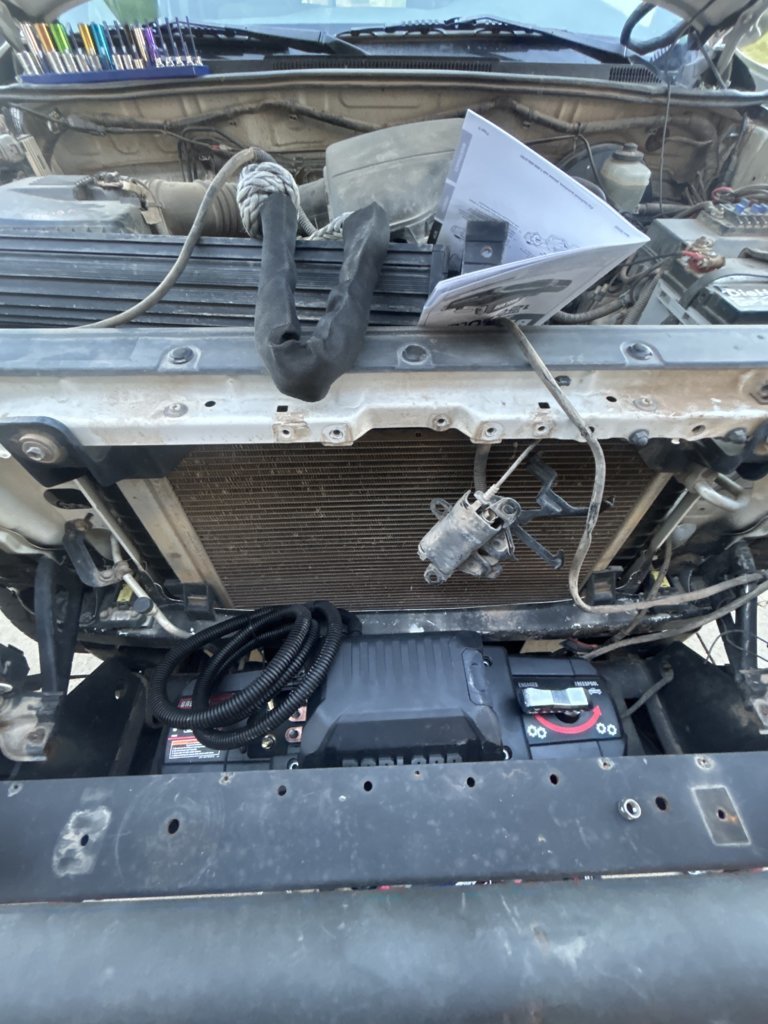

    Hey yall. Trying to figure out where I’m going to put my control box for my 12k Badlands Winch on my Demello Offroad bumper and it seems like the only option I have is to either make a bracket that goes in front of the condenser or buy one.
    Before I do that is there any other better alternatives that y’all are doing with the 2nd gen Tacomas.
    Also does mounting in front really affect all that much? I can’t imagine it would cuz you know there’s a whole AC condenser in front of the radiator. I doubt 6 inches raised off it would affect it that much but let me know.
