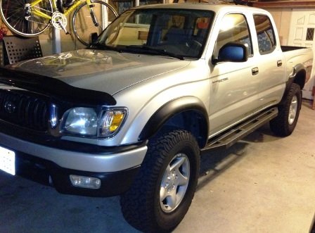

    Before/after:
    0_zpsf5fc0e20_ad360980e9fc26fb3d6f1bca592a1b844d0bc971.jpg 01_zpsdcdda1b3_224f511d2d05678d8f42e1a4355393f8e6474aeb.jpg

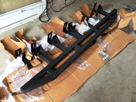

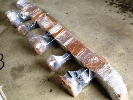

    Here's what arrived (about a month later than they told me it would)
    1_zpsde8ade2b_14e2713c43cfe5ded961580fd5c49da12cbd3031.jpg 2_zpsfcbe7579_5c8cdf65a0f5b8aa8f4ce8e92d3e921e95816a5f.jpg

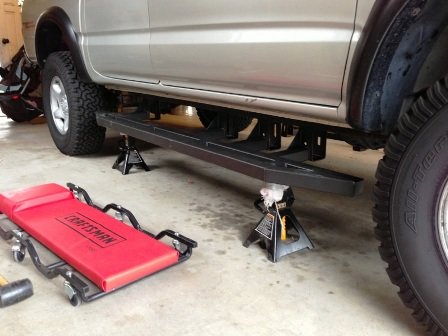

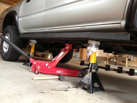

    My bro-in-law eventually gave me a hand, but it's possible to do solo with jack stands & a jack:
    3_zpsc7e9796d_655a55f840c7ba8c96792b453533cb7f3548eaed.jpg 31_zpsab41b8de_2eddc460ac44f43e7bbd6930befca7f2329ce822.jpg

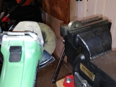

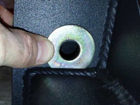

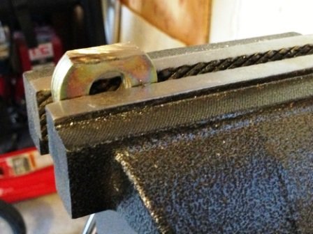

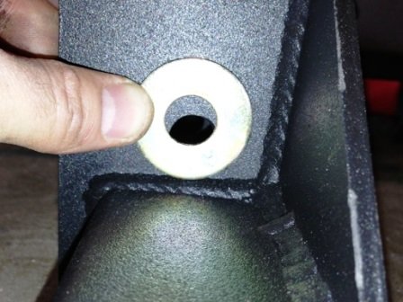

    1. Washers too big to fit flush (welds get in the way)
    Solution: Vice and grinder. No big deal.
    5_zpsc4fd73a1_11bff11951c93bc4ab283b315691384f5d790e97.jpg 6_zps54131639_9e77b44c4f7bb0e5d5c67530f5f446ce4e6ebf4f.jpg

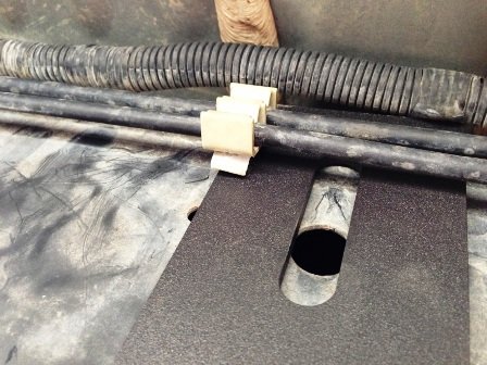

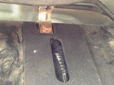

    2. Clip is in the way. I just pulled it out and tucked it above the frame.

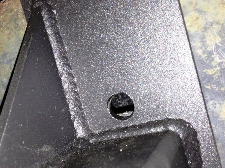

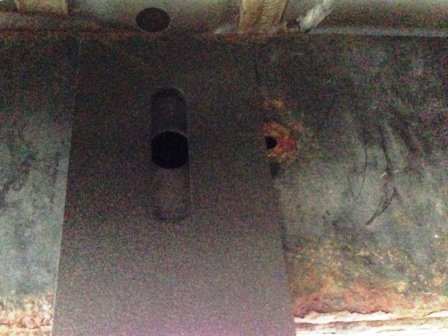

    3. One of the holes on each side (2nd from rear, I think) is 1/4" low on the slider, so you'll have to either expand the top of the slider holes or the bottom of the frame holes:

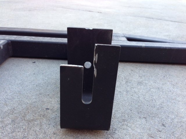

    4. No provision for the bracket bolt on the front driver side mount. I notched the slider to make room.

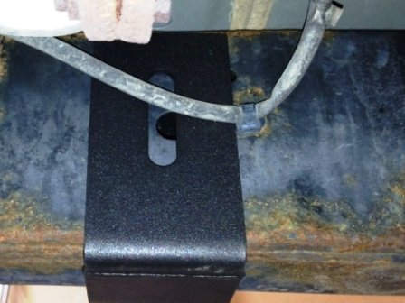

    5. Another clip on the driver side that has to be removed. I just left it out as pictured:

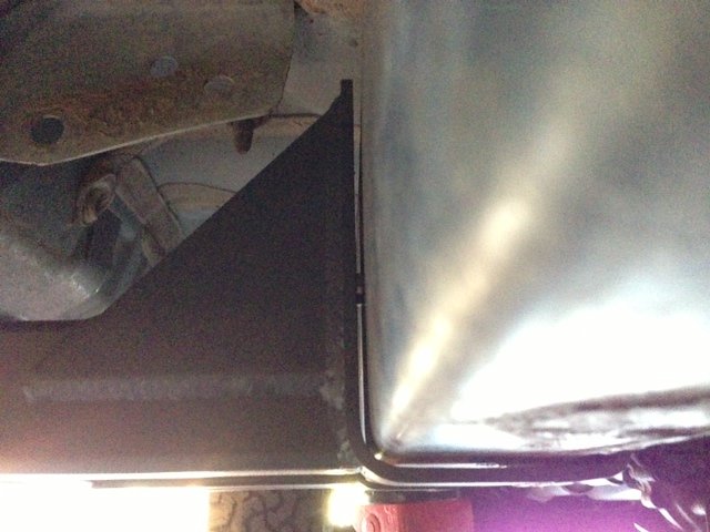

    6. Demello's install instructions said the kit comes with supplies to space the brake lines on the driver side so the sliders don't rub. It was missing, and when I called Demello they said it doesn't come with it, even though it's on the instructions. :confused: Ok, whatever, another trip to the hardware store for bolts and washers:

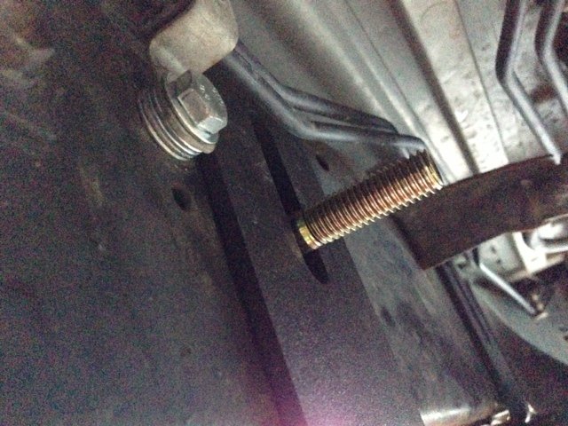

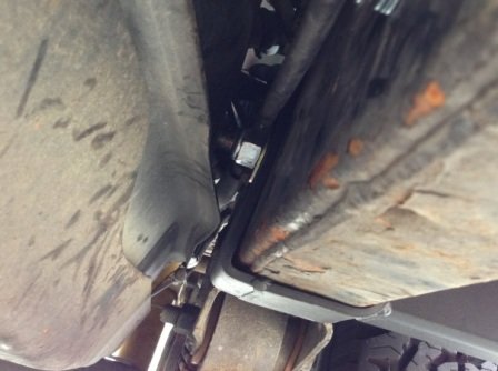

    7. Rear driver side bolt is too long, runs into the gas tank. Again, the supplied instructions said 2 bolts are shorter, but all 8 I got are the same length, so I had to cut one down. Again, not a huge deal, but just one more PITA to add to the growing frustration of the project.

    I decided to make the bolts work. I expanded the hole on the one side with a carbide grinding bit in my drill. It took awhile, but it eventually did the trick. I just left the 4th bolt out of the other side, as per JDEMELLO's suggestion.

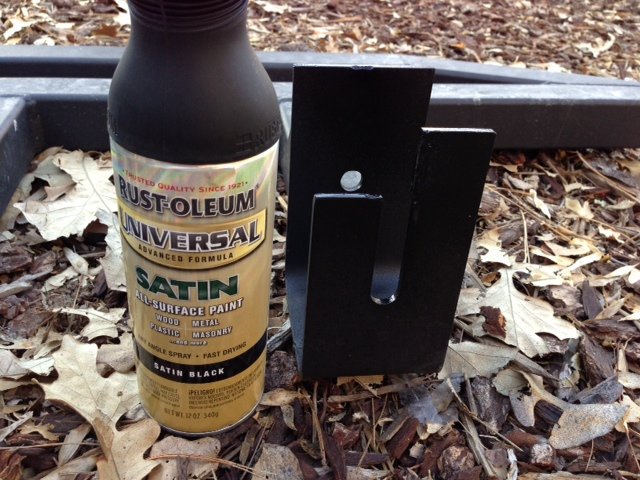

    1. The front driver side mount still wouldn't fit, so I had to get the cutoff wheel back out. Then I filed off the burs and painted it (same paint I used for my fender flares & side mirrors a couple years back)

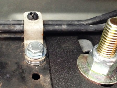

    2. Found another bolt that was too long - threads don't go deep enough to tighten fully:

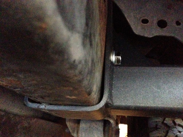

    3. The tolerances for some of the mounting brackets around the frame are pretty far out; you have to rely on the bolt hanging on the bottom of the hole instead of the slider cinching up to the frame, which is fine functionally, but makes it so you can't level it perfectly from front to back:
